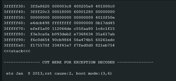

even if i upload a simple blink code in the nodemcu esp8266 i keep getting this error repeatedly in the serial monitor
ets Jan 8 2013,rst cause:2, boot mode:(3,6)
does anyone know how to solve it. if anyone does would love to get the help.

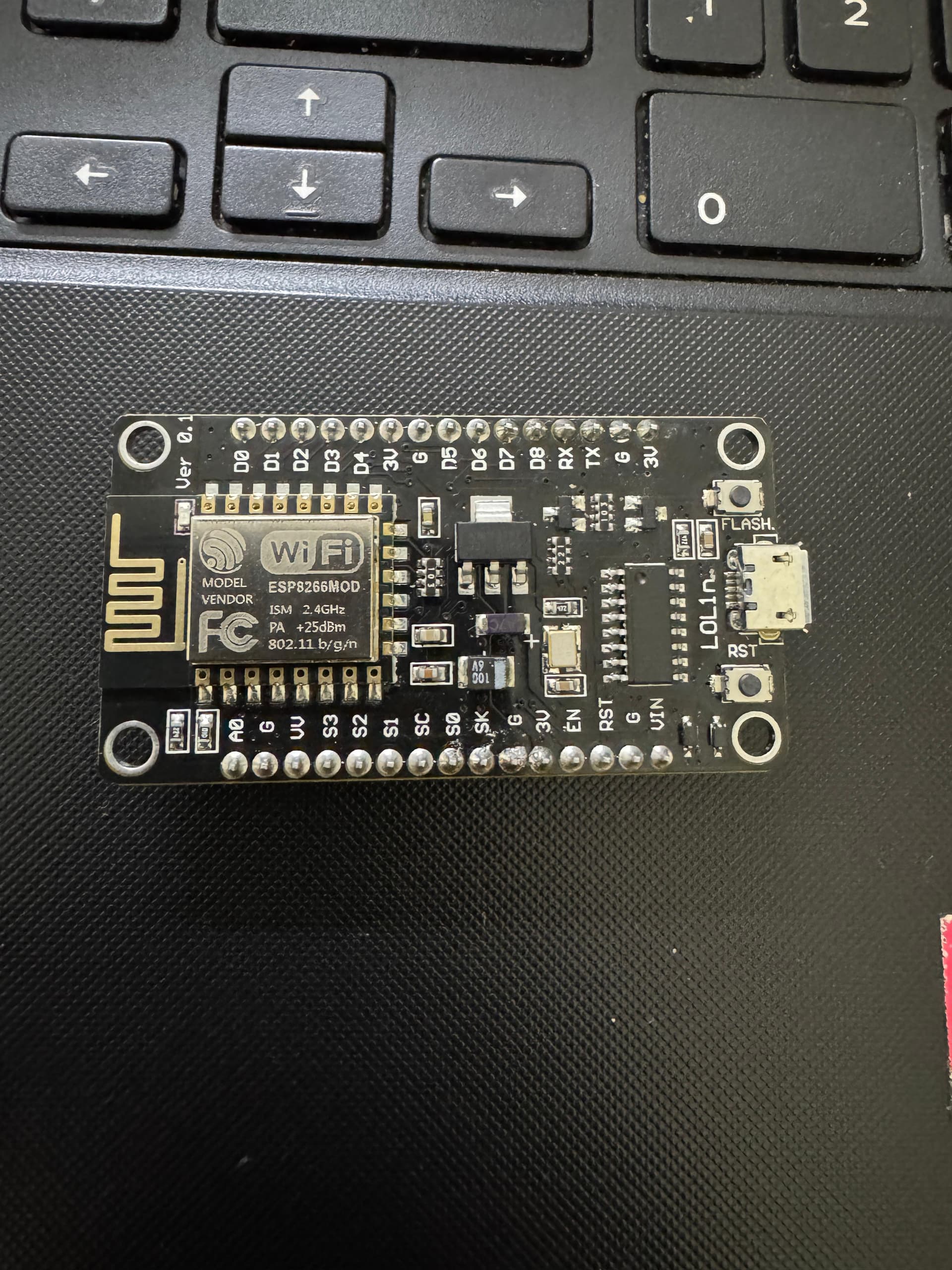

can you give a link to the the specific ESP8266 board you are using - or at least a photo?

i have the lolin nodemcu esp 8266 v3(i only know this much about the board)

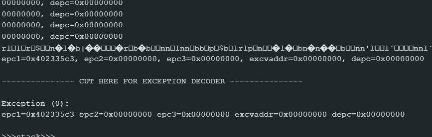

i used the code from the examples i got this repeatedly
after i used your code and connected an external LED im getting this repeatedly
my NodeMCU ESP8266 looks identical to that in the photo in post 3

have you anything connected to the ESP8266 PCB?

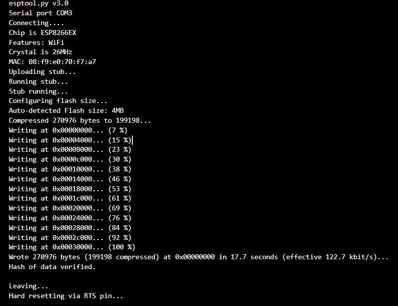

have you tried pressing RST and FLASH as you load
try File>Preferences and click "Show verbose output compile upload"
when you compile and load it should display something like
esptool.py v3.0
Serial port COM10
Connecting....
Chip is ESP8266EX
Features: WiFi
Crystal is 26MHz
MAC: 60:01:94:1f:7b:ee
Uploading stub...
Running stub...
Stub running...
Configuring flash size...
Auto-detected Flash size: 4MB
Compressed 271008 bytes to 199224...
Writing at 0x00000000... (7 %)
Writing at 0x00004000... (15 %)
Writing at 0x00008000... (23 %)
Writing at 0x0000c000... (30 %)
Writing at 0x00010000... (38 %)
Writing at 0x00014000... (46 %)
Writing at 0x00018000... (53 %)
Writing at 0x0001c000... (61 %)
Writing at 0x00020000... (69 %)
Writing at 0x00024000... (76 %)
Writing at 0x00028000... (84 %)
Writing at 0x0002c000... (92 %)
Writing at 0x00030000... (100 %)
Wrote 271008 bytes (199224 compressed) at 0x00000000 in 17.5 seconds (effective 123.7 kbit/s)...
Hash of data verified.
Leaving...
Hard resetting via RTS pin...
what does it display?

before it was showing me the error or whatever this is "ets Jan 8 2013,rst cause:2, boot mode:(3,6)" in the serial monitor now it shows nothing
if i click reset it also give me this in the serial monitor
the program load look OK
have you set the serial baudrate to 115200? e.g.
before your Seria.print() text these is usually some characters which are ESP8266 boot messages which you can generally ignore
yes the baud rate is set to115200
