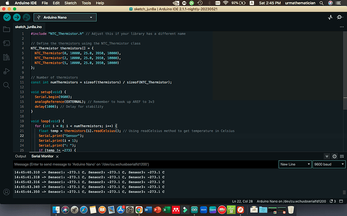

Error in using NTC_Thermistor.h library
I am making a triple Arduino nano code in which I used Thermistor .h library but it doesn't read the data from sensors the answer is (-273 C) it should not be this. (sensor 1 =-273 C, sensor 2
=-273 C, sensor 3 =-273 C)
Also I had used many codes on calculations they worked but there are many loses in them example ( sensor 1 = 36.78 C, sensor 2 = 36.90 C and sensor 3 = 57 C)
Please help me to fix this code.

I would start by using a simple sketch that only reads the analogue voltage of A0, A2 and A5 and sends that data to the serial monitor. Do you get values that vary depending on the temperature?
I think you have it wired backwards.
The thermistor should connect to GND and the resistor to 5V

See the wiring diagram in the link to the library
No
Use your existing wiring and just read analogue voltages on the inputs and print them. That way you can know that your wiring is OK.
Diagram
I'll try this
If you use 5V don't forget to remove the analogReference statement from your code.
Are you using the classic nano?
Still same error even I connect wires according to circuit diagram and remove analog terms

REMOVE the analogReference statement
Thanks its working
