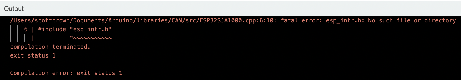

Hi there, I'm looking for assistance in fixing a set of errors I'm having with the Arduino CAN Library [CAN - Arduino Reference] as I try to use it with the ESP32S2 Dev Module. I've been following this link as a guide for using the CAN library for the ESP32 system [What is CAN Bus & How to use CAN Interface with ESP32 and Arduino - CIRCUITSTATE Electronics].
When I try to compile the code I first received a message stating:

Thank you for the response. For this project I'm using the ESP32S2 Dev Module from Espressif's esp32 system. The minimal reproducible example of the code is the inclusion statement for the CAN library:
#include <CAN.h>
Which then produces the following error:

It looks like you need another library as well.
I just installed the CAN library. I then loaded the sample sketch CanReceiver and it compiled clean for a NANO but failed on missing esp_intr.h. I am stumped for the moment.
I just rolled back the esp32 boards to 2.0.17 and it compiled BUT it has the following warning
 #warning esp_intr.h is deprecated, please include esp_intr_alloc.h instead [-Wcpp]
It looks like the author has not fixed the library code. You can either do the same and roll back, but then you will need to do that any time you were working with CAN unless you blocked ALL updates which I strongly advise against. Try contacting the author on github.
Thank you so much for the help. I've spent some time working on a solution to be able to use the CAN Bus system on the ESP32 without having to rollback the boards. I found a simple way to get CAN to work by using the 'ESP32-TWAI-CAN' library [ESP32-TWAI-CAN - Arduino Reference] which is more bare-bones than the CAN library but this can be supplemented by reading over the TWAI documentation for the ESP32: Two-Wire Automotive Interface (TWAI) - ESP32 - — ESP-IDF Programming Guide v5.3 documentation.
I used this following code to test this library:
