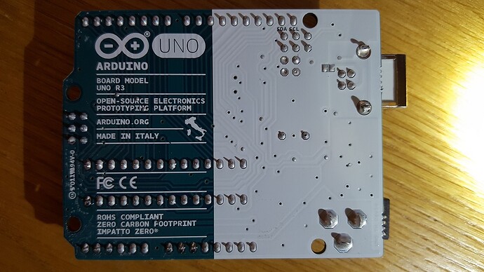

Hi - thanks for another reply - much appreciated
I have attached ....
  1. UserAccount.jpg - a picture of my user account - hopefully it's the right administrator type
  2. Chip.jpg - a picture of the chip
  3. Board.jpg - a picture of the board from the front
  4. BoardBack.jpg - a picture of the board from the back
    I hope these help - if you need anything else then just let me know
The laptop is a Lenovo Z50 - not sure if that's relevant or not. The drivers and board work fine on my custom built desktop.
The board is probably a couple of months old - my wife got it as a present for me and I think she's hidden it for a couple of months.

I'm still absolutely stuck with this problem.
I tried the Zip file tonight after removing the whole Arduino installation but still got the same issue.
The board looks like a Real UNO so I doubt that is the issue unless that chip is broken somehow.
Your laptop does have a USB 3.0 port so make sure you are NOT using that.
As your also has USB 2.0 ports you should try those. In most circumstances they will work.
