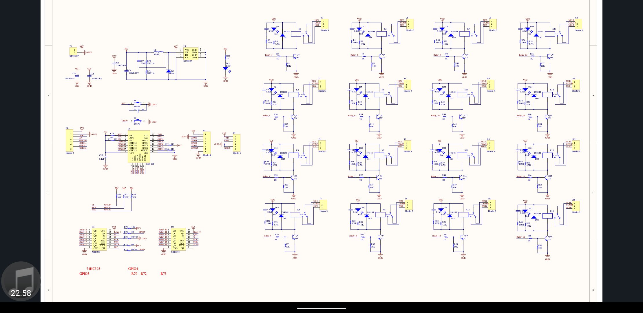

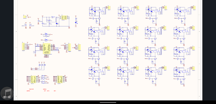

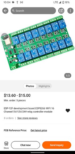

Esp12f board with 16 relays
Hello Friends just to know if someone can find the complète schematic or the file datasheet of the Esp12f board with 16 relays.

Google found me this thread about the board. Basically what you need to do is find the pins connected to the 2x 74HC595 daisy-chain.
In post #15 there seems to be the correct pins. Further on there are some more samples.
There is even a link to the full manual of the board, but F-secure told me not to surf there, it is a little over-protective of me.
Thanks I have found it
mark this as the Solution
So looks like the hwSPI pins are used actually 12, 13 & 14
