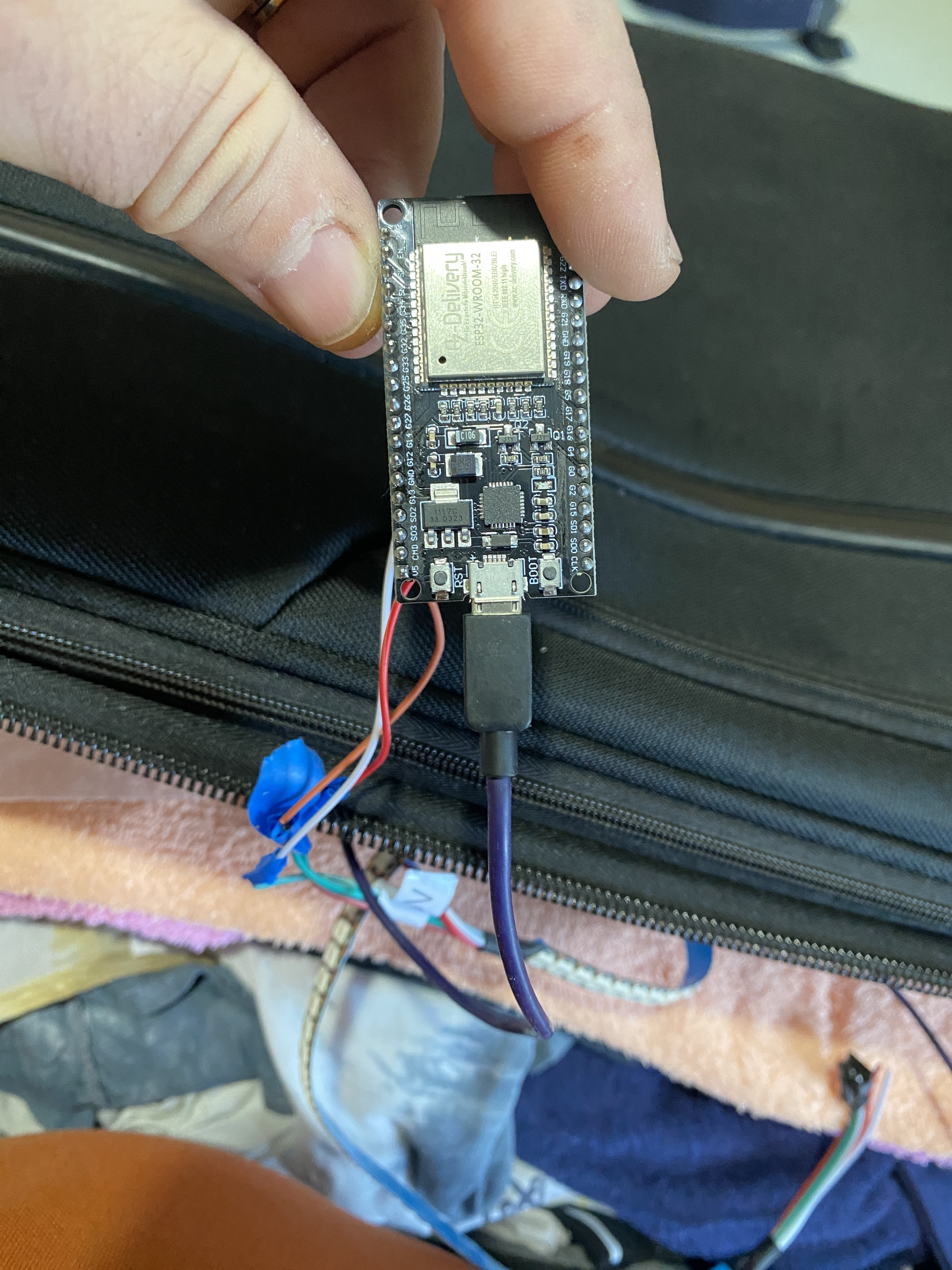

Hello
I have a esp32 wroom cp2102 : https://amzn.eu/d/2oD7OI6
I m using a standard belkin standalone battery - linked to the usb entry of the arduino
Here are some photos of my set up (working perfectly so far !)
Thanks for your help
That is a normal ESP32 module :white_check_mark:
The "ESP32-WROOM-32" (written on the metal part) is good :white_check_mark:
The Belkin BPZ002 is 5V power bank :white_check_mark:
The ESP32 module is powered to its 5V and a GND pin :white_check_mark:
That is alright so far.
The black connectors that you push onto the ESP32 module are often weak. I hope you have stronger ones and not the cheap flimsy ones.
Do you have a soldering iron, shrink tube, or tools to clamp wires together ?
All the GND and also all the 5V (for ESP32, ledstrip, PAM module) should be tied together.
Hi
Thanks for your advise. It s just a prototype so far. I will solder and make everything stronger once everything will be OK.
The power bank is plugged on the usb entry of the esp32.
The led is connected to the gnd and the 5v pin.
I wonder how to connect the Pam to the arduino providing leds are already connected to the 5v and gnd output of the arduino.
Okay, powering the ESP32 module via a USB cable is even better.
Sometimes there is a diode from the USB 5V to the 5V pin.
Can you measure the voltage at the 5V pin ?
The ledstrip and PAM module should still work if the 5V pin has only 4.5V. If there is a diode, it should be able to deal with the extra current.
If you need to connect 1 or 100 wires to a pin, then you have to connect those wires one way or the other. I prefer soldered wires with shrink tube. Cut the wire, strip the isolation, add the extra wires, place shrink tube over the wires and shift it out of the way, solder all the wires together, shrink the shrink tube.
It is a good time to show a drawing with the wiring. I don't like wrong currents when one of the connectors gets loose.
Hello Koepl,
sorry for the late answer, I was travelling abroad with no access to pc and voltmetre.
I'm just back and draw a picture of my current full setup. The measured voltage is 5.04V out of the pin:
There is no diode so far in my setup.
