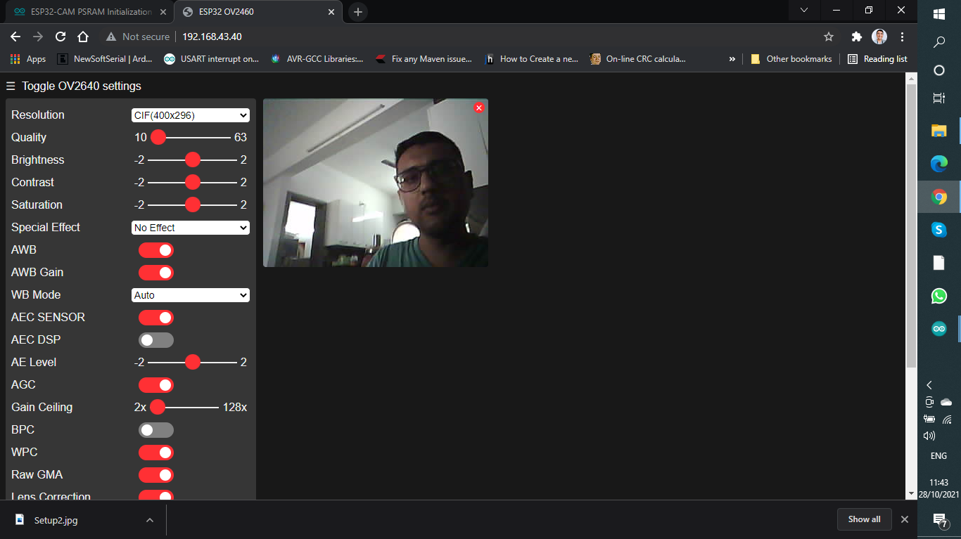

I resolved the issue that was challenging my patience.
Here is what I did :
I removed the connection between IO0 pin and Gnd
I opened the serial monitor of Arduino IDE.

I entered the URL 'http://192.168.43.40' and saw the default webpage of ESP32 CAM. I kept settings as they were and clicked the "Get Still" button. Here is the screenshot :
