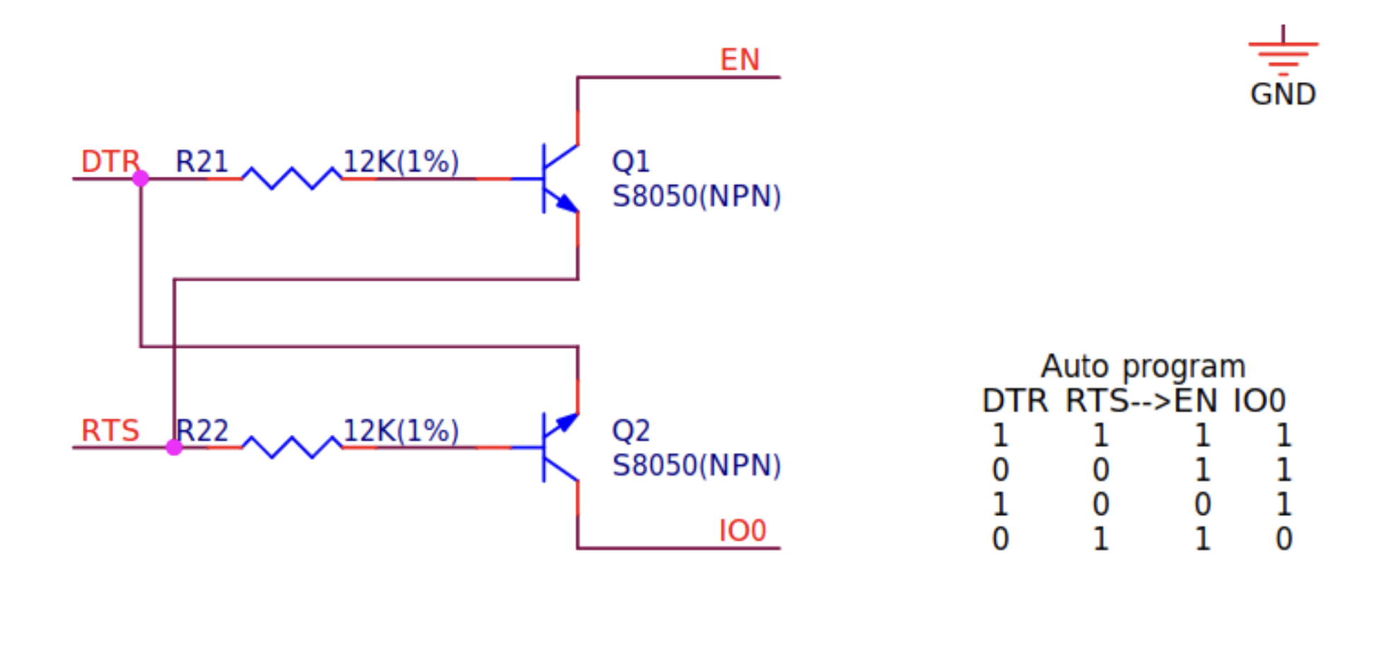

My DIY ESP32 PCB needs: Reset hold, Boot hold, Reset release, Boot released.
At which point the sketch can be compiled/uploaded.
This is the schematic.

I did this to all my ESP32 that failed to upload.
[SOLVED] Failed to connect to ESP32: Timed out waiting for packet header | Random Nerd Tutorials.
Now I don't have to stuff around pressing buttons, just tell the IDE to upload and away it goes.
PS. Mod has been around for years.

What two pins is the cap across and what uf do you use please?

A 10uf capacitor between EN and GND pin, it can be done on a bread board if you are unable to solder it.
This circuit is often found on ESP boards to circumvent the need to push buttons.
