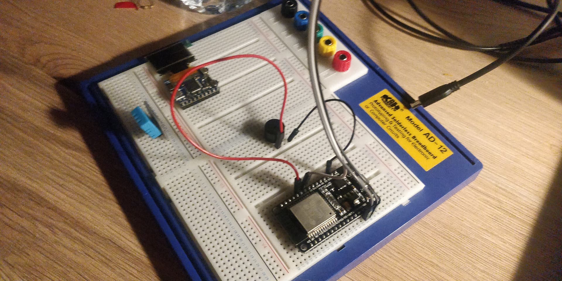

Right so ive search high and low and I cant figure out why my ESP32 Devkitv1 is running the setup and loop once and then rebooting
here is the serial port stuff that comes out every time
Rebooting...

[��mum����2-hal-cpu.c:211] setCpuFrequencyMhz(): PLL: 480 / 2 = 240 Mhz, APB: 80000000 Hz
VMDPR_Setup start
Setup end
1
2
Buzz
if you can pls help
Can you provide code using the code tag </> and a schematic of what you have hooked up?
...especially whatever you turn on just after you print, "Buzz". :slight_smile:
If your board is DOIT ESP32_DEVKIT_V1, you have to select correspondingly. Selecting ESP32_DEV, etc. will cause the board to reboot like that.
You can also have to add delay(1) in the loop(), such as
  delay(1);

The thing above is the IR sensor
See the error with the above?
When you loaded the debug info into the ESP Exception Decoder what was the decoded message?
The op might want to learn more about the tone32.h library being used and how the numbers being sent to the tone32 library affect the ESP32's LEDC API, clicky clicky, and how those numbers are effecting the HardwareTimers and how the pitches.h numbers are interacting with the hardware timers.
As @Idahowalker said, just change the frequency will solve your reboot issue, such as
tone(BUZZER_PIN, NOTE_C7, 500, BUZZER_CHANNEL);
noTone(BUZZER_PIN, BUZZER_CHANNEL);
tone(BUZZER_PIN, NOTE_DS8, 500, BUZZER_CHANNEL);
The ESP32 MCU doesn't have as much driving power on its pins as Arduino UNO's 328P MCU. If you wish to use a buzzer, you need to drive it with some transistors. Even if you don't want transistors, you should use some resistors such as 500 ohm in series with the buzzer. Directly connecting the buzzer to an IO pin may cause damage to the pin. I have a similar looking buzzer. Whenever I turn it on, there is the order of hundreds of mA of current through my circuit. If you disconnect that buzzer and run your code without modification and it runs without reboot, you know it's the buzzer. Adding the resistor will make the sound very soft. Best is to use a transistor to drive it. Better than best is if you are already familiar with transistors and use two transistors and drive the buzzer with 5V.
