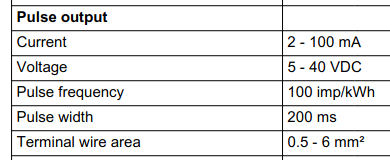

I want to read the pulse output of an electricity meter marked 5-40 VDC 1000p/Kwh with an ESP32. What do I need to do to protect the ESP32 from over voltage?
Possibly an opto-coupler with an appropriate series resistor for its internal LED.
Sounds like open collector output to me. What do the terminal markings say? Can you post a picture?
https://library.e.abb.com/public/f1db7577ce344f97ac2c5621cc8fd74d/2CMC486001M0201_B_en_C11_User_Manual.pdf?x-sign=pVu7AdCVZvHS0SL9Slxg1xL5eX+0l8oJIaBao391Itg4Frj+EhCpW/bs/t/biX5h
Link corrected: https://library.e.abb.com/public/f1db7577ce344f97ac2c5621cc8fd74d/2CMC486001M0201_B_en_C11_User_Manual.pdf
It would appear that this is indeed, an opto-isolator built into the meter, so requiring no additional isolation though you could add a second opto-isolator "just in case".
As it is, you connect it to ground noting the polarity specified, and provide a 2k2 pull-up resistor to 5 V to provide the specified 2 mA bias.

OK, as I said, "-" terminal to ground, 2k2 pullup to 5 V on the "+" terminal, then a diode with cathode to the "+" terminal, anode to the ESP32 pin and use INPUT_PULLUP.

Thanks, I tried as per the sketch above. It works even if I feed it with the 3.3v from the ESP32.
It probably does. I was just going with the minimum 5 V and 2 mA specified in the datasheet but if it is simply an optocoupler in the device, there is no particular minimum of either.

For this one on 3.3 V, you do not want the 320 Ω resistor, but put a 10k for protection between the meter device and the ESP input.
