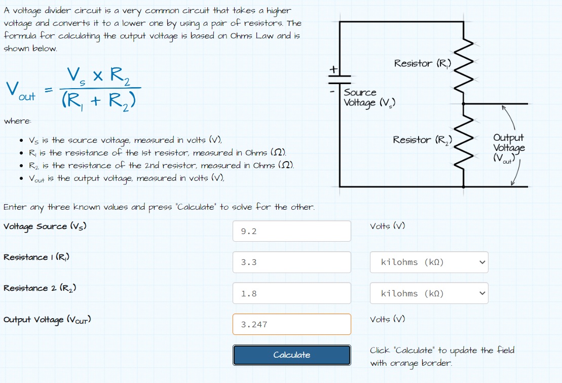

I am trying to get my ESP32 to read pulse output from an NE555. Pulse duration is 12 seconds, voltage 3.4V and current approx. 78mA.
Trouble is I am getting fluctuating values when pulse is ON on GPIO pins and even input-only pins.
This is my board: https://esphome.io/devices/nodemcu_esp32.html
I have used a 10k pulldown resistor, then the internal pulldown resistors (after removing external one), and finally even a 1k pulldown.

Your connecting a voltage of 3.4V to the pin of the ESP32 which has a supply voltage of 3.3V ?
Current is being drawn by a few resistors I put in between the NE555 output and the ESP pin. Here is the schematic:

(Edited the circuit to correctly show how voltage output from resistive network was being fed to the ESP. Previously it was shown connected to input of resistive network i.e. 9V2)
It is being supplied by the micro-usb from laptop. The pins are all 3.3V
Yes Ive attached the schematic. The issue is with the way the ESP is receiving the voltage, the NE555 works fine and does what it is supposed to
The 555 is using 9V2 and the ESP32 is a 3V3 device?

What do R1, R2, R3 and R4 do?
In your circuit they do nothing.
Where is the current limit resistor for the LED?
The 78mA is possibly caused by the LED with no current limit resistor.
Can you please tell us your electronics, programming, arduino, hardware experience?
Can you draw your circuit with the LM555 in the circuit?
Schematic does not look right.
Do you really have the LED directly connected to around 8.5v ?

You NEED and have not got a resistive potential divider to drop the 9.2V pulse from the LM555 to 3.4V to feed the ESP32, do understand that.
Can you tell us how you calculated the resistors, and why you have not used a potential divider?
Corrected the diagram
PLEASE do not go back a correct diagrams, post the corrected diagram in a new post.
How did you work out the resistor values?
220//220//330 = 82 Ohms
Are you sure the LED is connected that way?
There are 3 of the 220 ohm and one of the 330 ohm. LED is connected exactly this way just to tell me when the pulse starts and stops so I can measure the voltage in between.
This may help;
From;
This uses less current and will provide the correct level to the ESP32.
Tom.. :smiley: :+1: :coffee: :coffee: :coffee: :australia:
PS, This was done in a hurry, please correct any errors if you see any.
Why and how 82 Ohms?
What current did you think your LED needs to operate?
Thanks.. Tom.. :smiley: :+1: :coffee: :coffee: :coffee: :australia:
