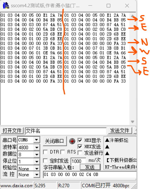

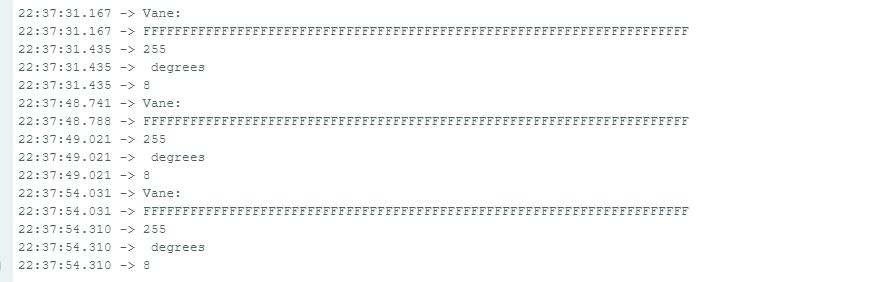

This is what I get from serial:
And this is what I get from the USB RS485 adapter connected to PC.
Sorry but executable given by provider is in chinese and couldn't manage to translate it. I just followed their instructions (uploaded below).

Mark and Horace, thanks for your quick reply.
Really good idea to test RS485 Modbus communication between ESP32 and PC first. I got sensor communication successful between PC and sensor but, not between PC and ESP32. I have been trying to replicate and follow your steps (with your code) and many others showed in many places about Modbus RTU; tried with TeraTerm, Putty, ModbusPoll but no success. I am a bit lost as I don't know exactly how to attack this point.
I was expecting to send a test request to the ESP32 from the PC in order to get your serial results, but don't know where to start from. How do I know what address should I knock in order to get answer? I understand that the ESP32 is waiting for an answer, so the problem is that I somehow don't get the query right. I would very appreciate if you'd know somewhere reliable to dive into, as all the tutorials and pages I've looked into were not showing "how" to do it - RTU Modbus communication between ESP32 slave and PC master.
And thanks for the comment about DI and R0 pins. I put them correctly but wind sensor (and neither PC communication) was not successful, so I guess is something about libraries/programming?
I understand RS485 Modbus protocol but every try I make in different ways results unsuccessful. I think my concepts are OK but cannot apply them correctly.

This demonstrates a common error seen many times with RS485 serial comms in this forum and on the web in general - especially when authors present their apparently working code for the NPK soil sensor (another Modbus sensor).
The issue here is that once the request for the data has been sent to the sensor and the RS485 transceiver has been put back into receive mode (ignoring any flush command as in this case I don't think it's needed with a software serial port), the code assumes that the reply from the sensor is instantly available and goes into a loop reading the expected number of bytes.
This generally results in the user getting a byte array filled with 0xFF. The 0xFF is there because the serial port is reporting back -1, which is its way of saying that no data was available because the sensor hasn't responded yet.

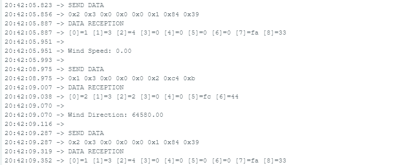

Hello!
Sorry for the delay in the answer; I have been advancing with the sensors measurements and Modbus RTU settings, and finally got the sensors readings OK. I got it without any library, just with Serial2 UART pins in the ESP32. I come back to you hoping you could help me. I have very little left!
I managed to buy a new RS485 TTL converter operating in 3,3V instead the 5V I had (as markd833 mentioned), and got to read the sensors independently with the ESP32 and Serial2, without any additional library. I can understand the code and even if I managed to change sensors settings to change ID number, and Baud rate (both at 9600), getting a code that could read each one independently, when putting them together I got stuck.
The thing is that Vane's answer to my query comes as the Anemometer's response and the Anemometers response comes with the Vane's query. This is strange as the ID's of both are different, specifically changed for so (Vane ID=1, Anemo ID=2). They are both connected in parallel to the same A - B wiring, let me show you a scheme.
I tried inserting delays in different places but no success. Also added a Timeout of 1000ms but stays the same. Is like if the vane answered to anemometer's query and viceversa. The strange thing is that if I disable anemo or vane's code lines, the other sensor measures correctly and response times are correct; 0.2s. What do you think can it be? Something related to the buffer?
Let me share with you my code.

This is the error I'm getting.
I hope you guys or someone could help me with ordering my readings.
Thank you in advance.
you transmit using Serial2 then immediately call Serial2.available() - it is possible nothing has been received in that time - put a short delay between the transmit and receive? delay(20) ?
I got it finally.
It resulted that somehow, the vane sensor was the one giving problems. Inserted 20ms delay between query and Serial2 reading, and something curious happened: I changed the reading order to first anemometer and then vane and it resulted.
