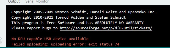

**** got a temporary result bu chosing arduino esp32 nano board and compiling/uploading using the esptool...but it only worked once and further compiles resulted in the no dfu error...which always happened when I compiled using the normal compile/upload button......
the last compile with the esptool resulted in losing the port connection.

If I set the board to nano I get:
if I set the board to nano and compile/upload with esptool It drops the port and I get:

As I tried(not very well as it happens) to explain in post 12 I could not get that waveshare board to compile and load with the arduino esp32 nano selected in IDE 2. It compiles and uploads successfully if I chose esp32 s3 dev board in arduino IDE 2.
For 4 days I tried every configuration of board choice I could and the board always returned wifi status IDLE(0). In desperation I tried one more time with the board selected as arduino esp32 nano and upload with esptool....it worked twice and then dropped the port connection and I subsequently couldn't connect to the board. I did the reset connecting B1 to ground and the chip got it's port connection back.
I subsequently recompiled and uploaded as normal with ESP32 S3 dev board chosen in IDE....it immediately worked, and has done ever since.
