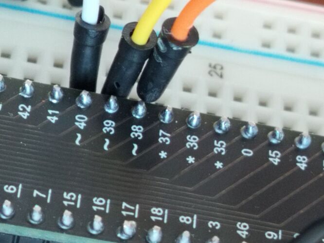

am trying to connect ESP32 S3 WROOM freenove with RC522 and use the dumpit example... am struggling with pins connections...
I've attached the pin layout of the esp32 model, appreciate guiding me on:
what pins on this esp32 model shall i connect the following to:
SDK, SCK, MOSI, MISO, RST
should i define all or just RST and SDK..
#define RST         ?          // Configurable, see typical pin layout above
#define SDK          ?         // Configurable, see typical pin layout above

Check out the sample sketches for the RC522. Hook that up, run the code to make sure the board works and the wiring is correct.
The default SPI pins for the ESP32S3 are;
MOSI: 11
SCK: 12
MISO: 13
But on the pin map you posted those pins are used by the camera.
So you will need to define other pins for MOSI, SCK and MISO.

That was the exact issue, I ended up using different gpios and it worked... The gpios that worked for this model were:
RC522 Pin ESP32-S3 Alternate Pin
RST GPIO 9
SDA (SS) GPIO 14
MISO GPIO 37
MOSI GPIO 35
SCK GPIO 36
Check the pinout you posted.
Those are the pins used by the PSRAM .................
True, double checked and it works fine on GPIO (35, 36, 37), also tried pins (38, 39, 40) and works as well..

Until you use PSRAM for the Camera which other people reading this thread, in the future, might well be doing.
Might be the reason why on your board pis 35, 36, 37 are marked differently ......
