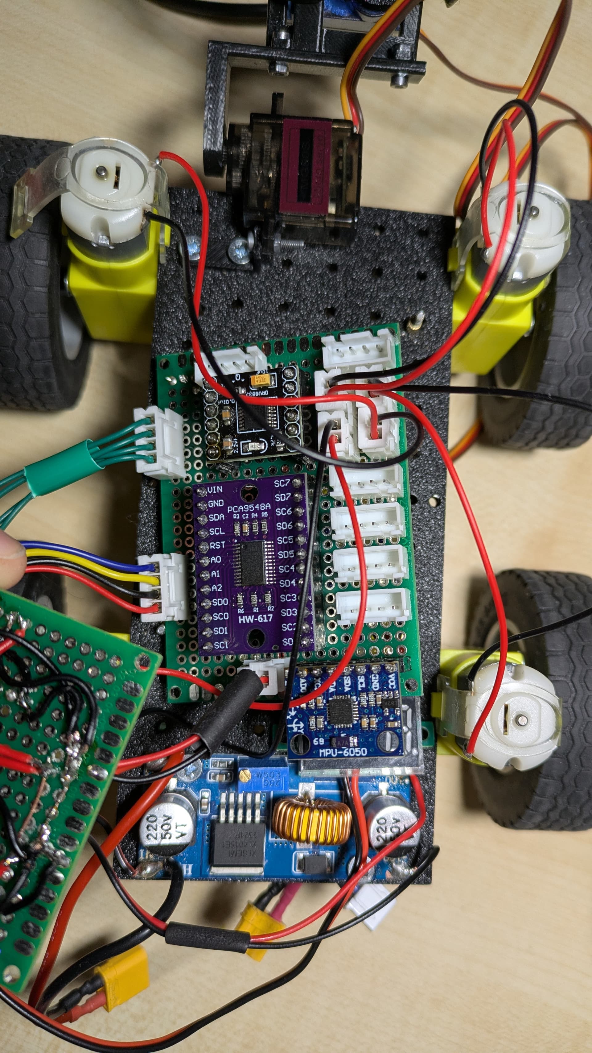

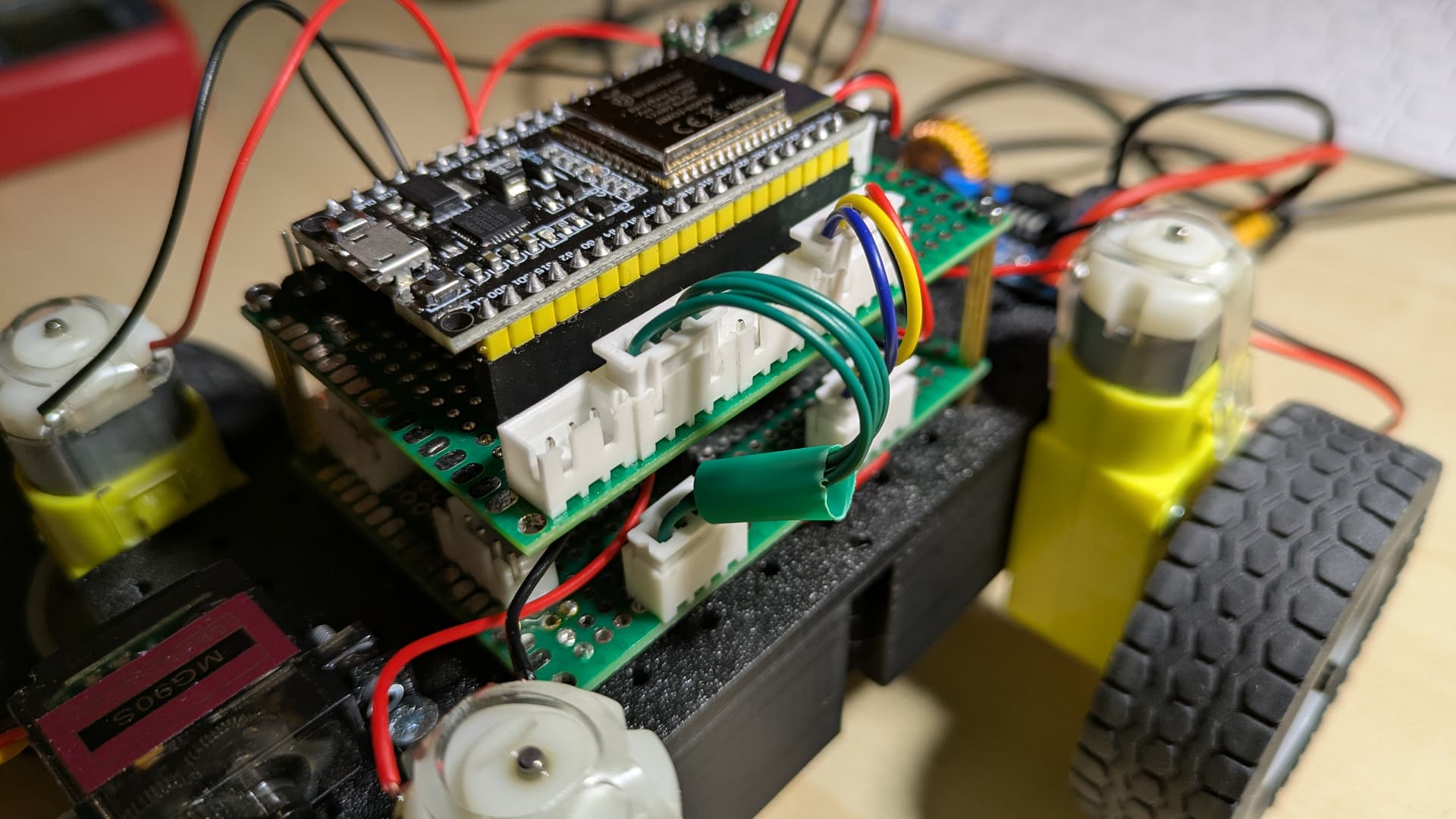

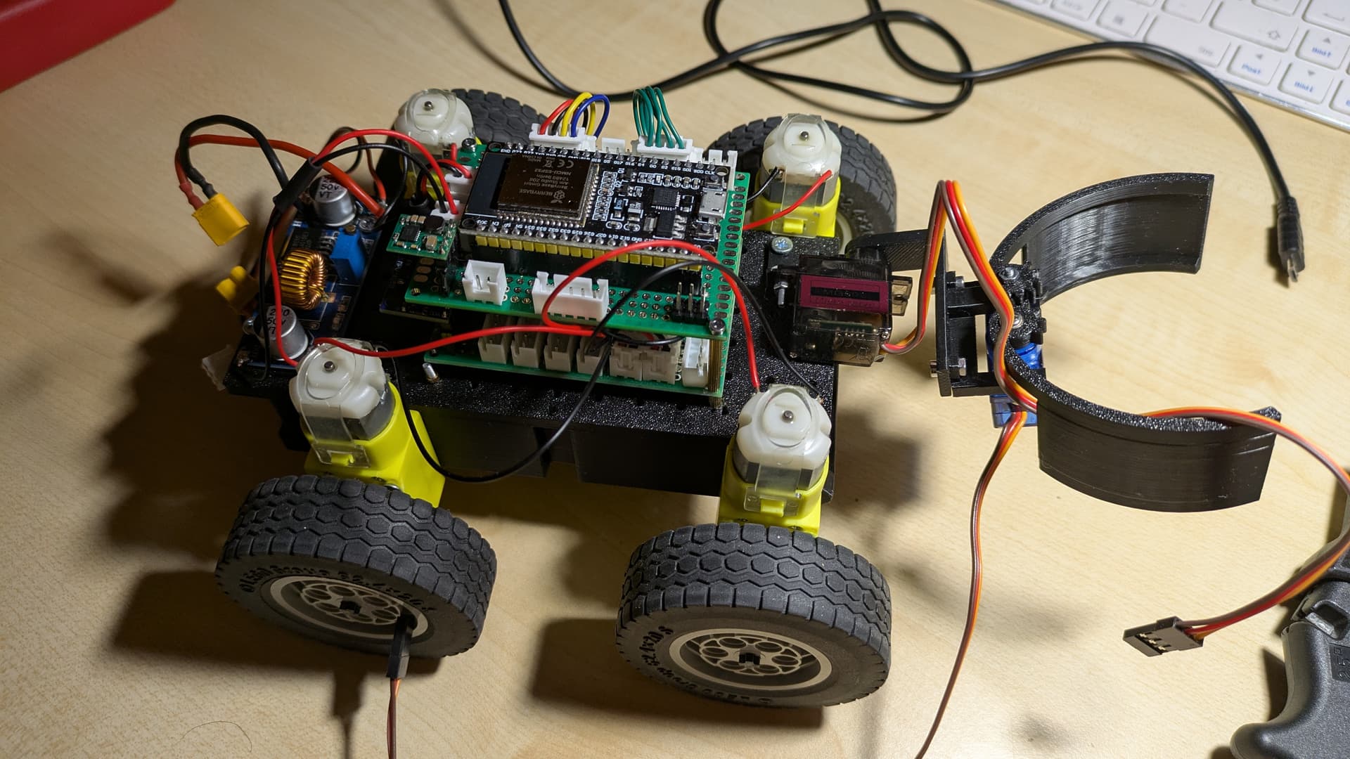

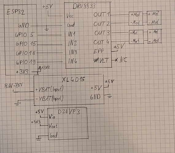

I'm currently working on a 4 wheeled robot, with 2 Servos for a gripper and 4 geared TT Motors to drive. I use a ESP32 NodeMCU to control everything. To drive the Motors, I use a DRV8833 dual H bridge, two Motors(on the same side) are connected to each other, because they are always driving the same speed and direction. The entire system is powered by a 2S Lipo(8.4v- 7.5v) that's lowered to 5V using a Step Down Converter(with a max current of 5A). These 5V are converted to 3.3V using an LDO and fed to the ESP32. The DRV8833 and therefore the motors are getting 5V. My problem is, that seemingly randomly(but often when I run the sides in opposite direction to rotate like a tank) the ESP32 "crashes" and starts spitting out random symbols in the console(my baud Rate is set to 115200). This happens even when not using the Servos or any other peripheral. Here is my code:

the console seems to be repeating some kind of "message", and the ESP32 just stops driving the Motors. This is all really confusing me, and I would appreciate some help.
Update: after further testing with the same code (and hardware), the ESP32 sometimes also reboots itself, during operating.
Please read and use this link: How to get the best out of this forum - Projects / General Guidance - Arduino Forum
Schematics are requested as the issue smells hardware and/or connections. Please mind datasheet links to none standard devices like "motors", "an LDO", servos....
Possible EMI (Electromagnetic Interference) Issue
This sounds like it could be related to EMI, either conducted or radiated. While I can't confirm this is the problem without more information, I also can't rule it out. Most MOS logic circuits are fast and sensitive to edge transitions. Minimizing lead lengths (which act as antennas) to less than 10 inches (25 cm) is crucial, as longer leads can pick up frequencies up to about 750 MHz, not accounting for reflections and other effects.

Thanks for all your ideas. Here is some more Information. There is a I2C multiplexer, but it isn't connected. The servos are SG90, but they aren't connected. Here is where I bought the Motors: https://funduinoshop.com/elektronische-module/elektromotoren-und-zubehoer/getriebemotoren/getriebemotor-tt-3-6v-mit-rad-felge-reifen
What do you mean by walking on memory?
