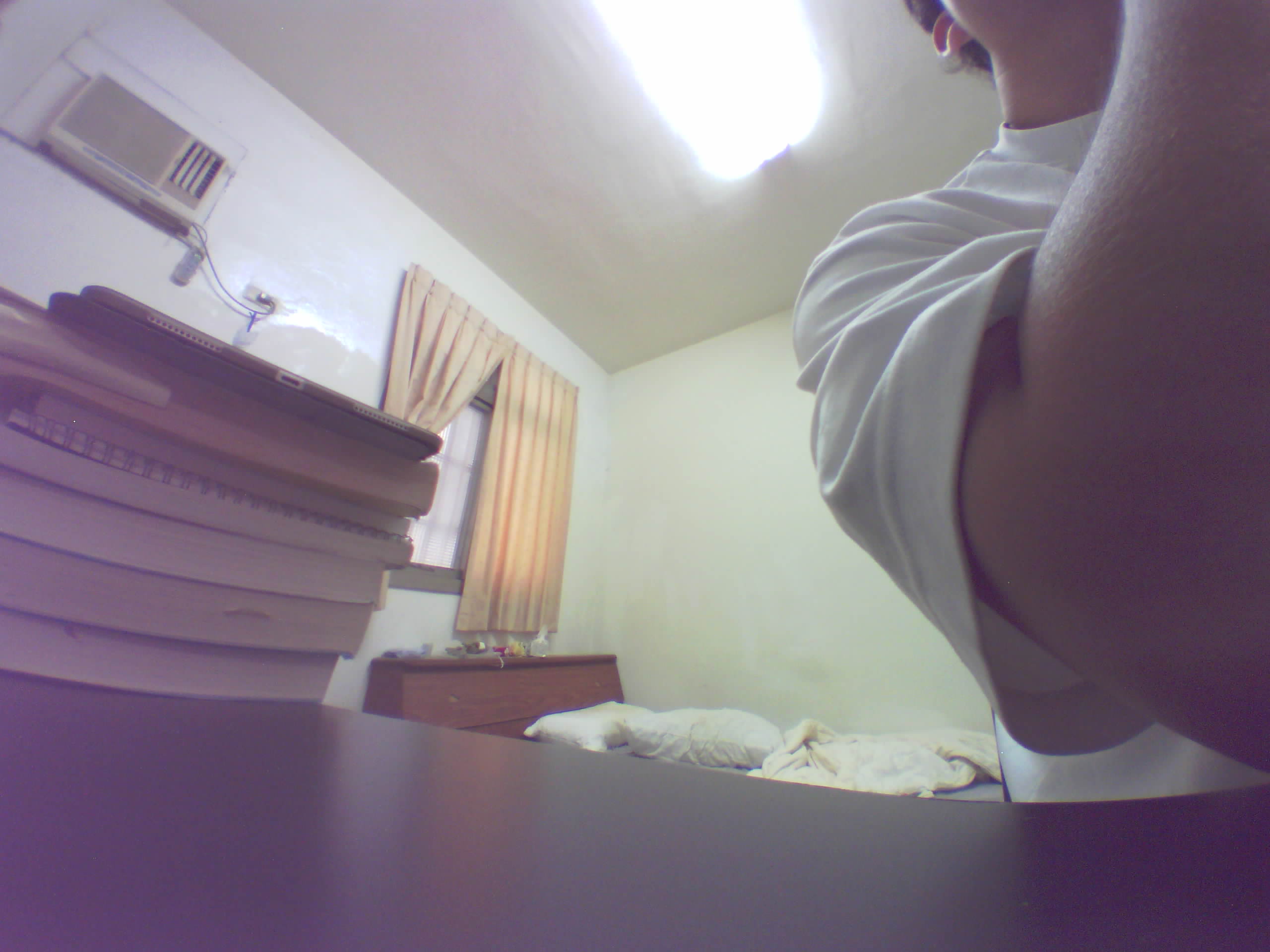

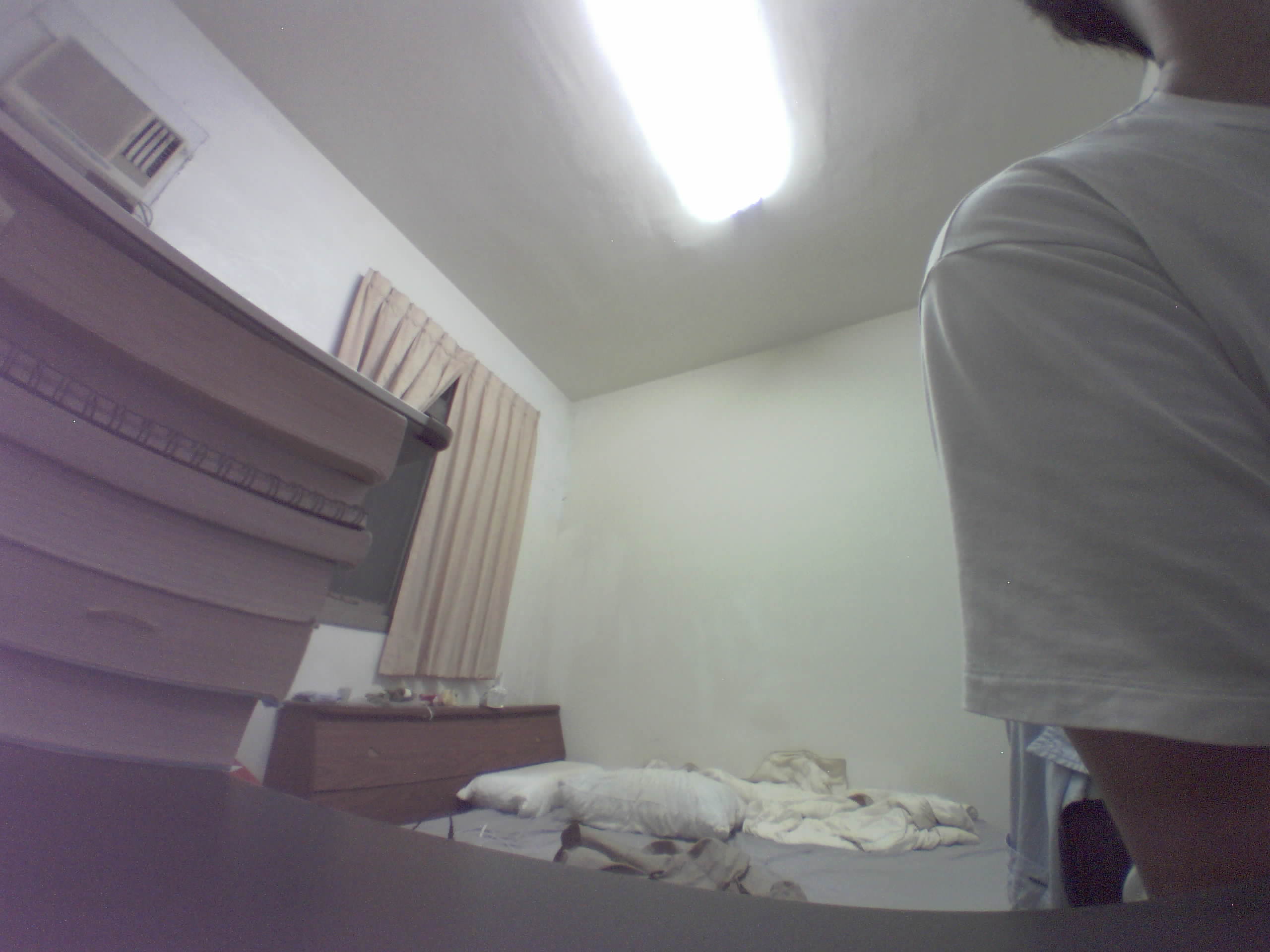

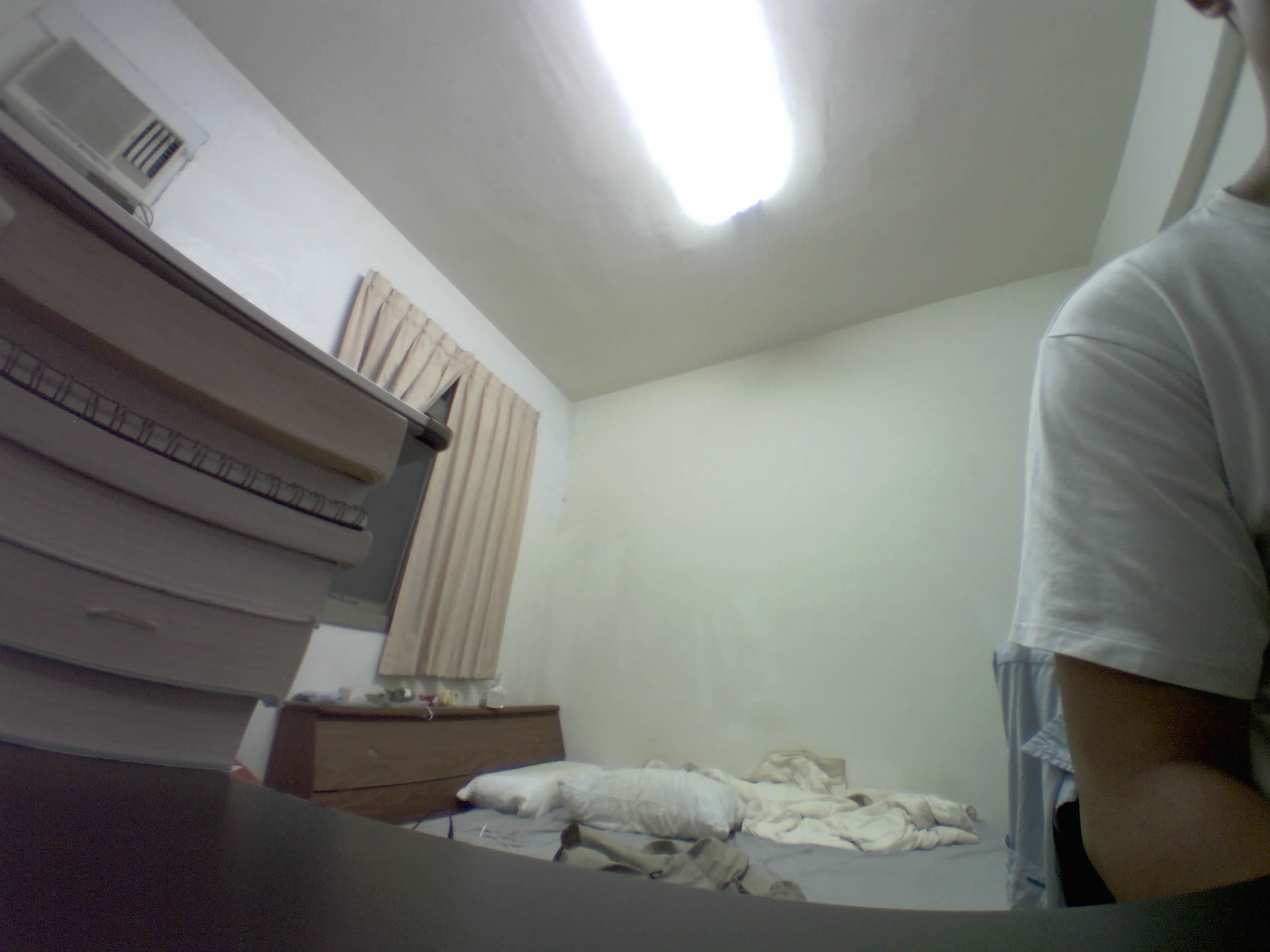

The problem I'm encountering is that after a first image-capture, the following image's quality got worsen, started to become grainy and getting greeny on the corner.
Here are a series of pictures I took:
Pic1:
Pic2:
Pic3:

It looks to me that the automatic white balance is unstable. Minor changes in the scene can cause that problem.
You might try experimenting with the camera configuration settings to see what works best.
Hi jremington, thanks for your advise! I did some tweaking on the white balancing and was manage to get rid of the greenery, I appreciate your help!

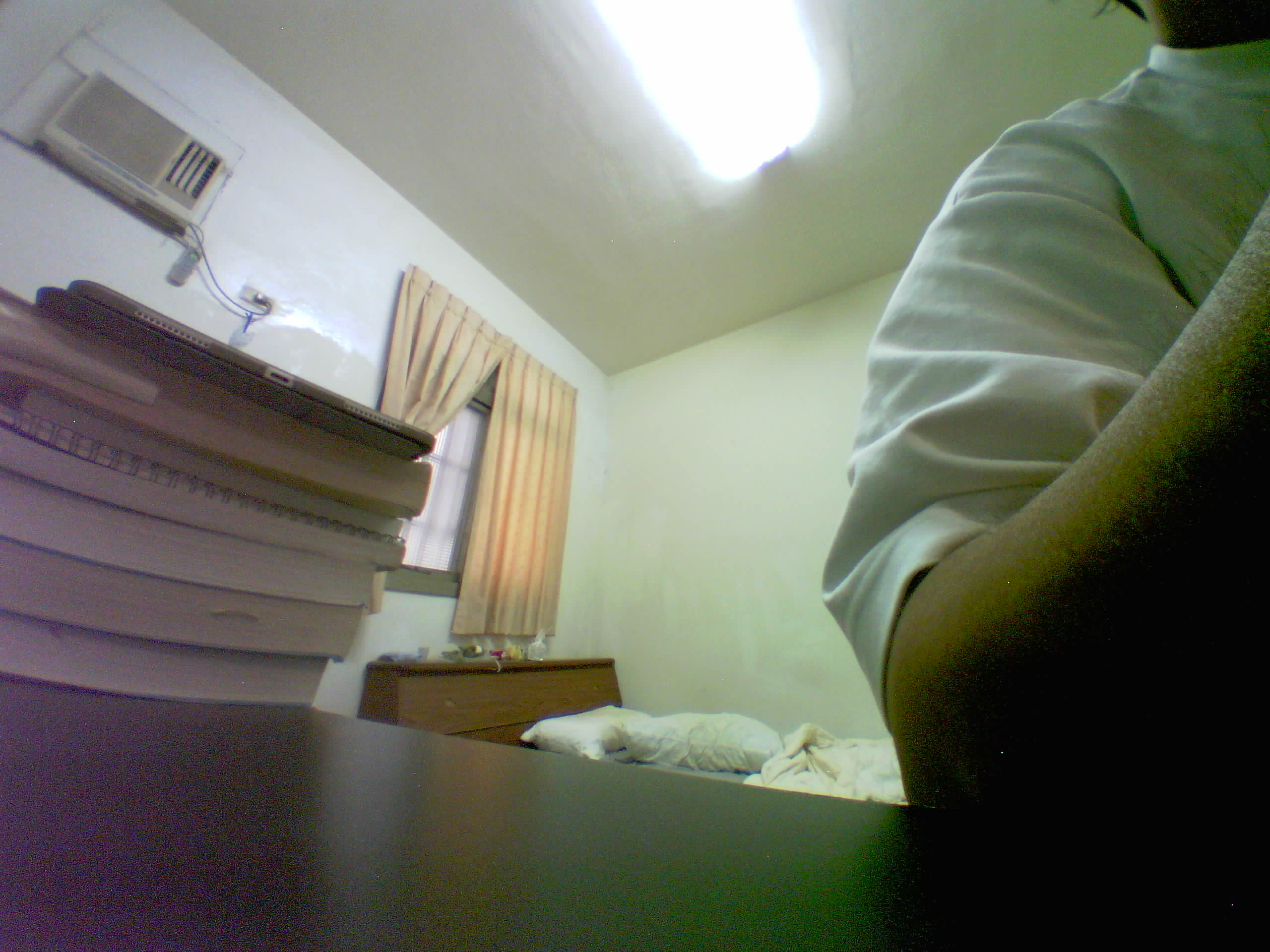

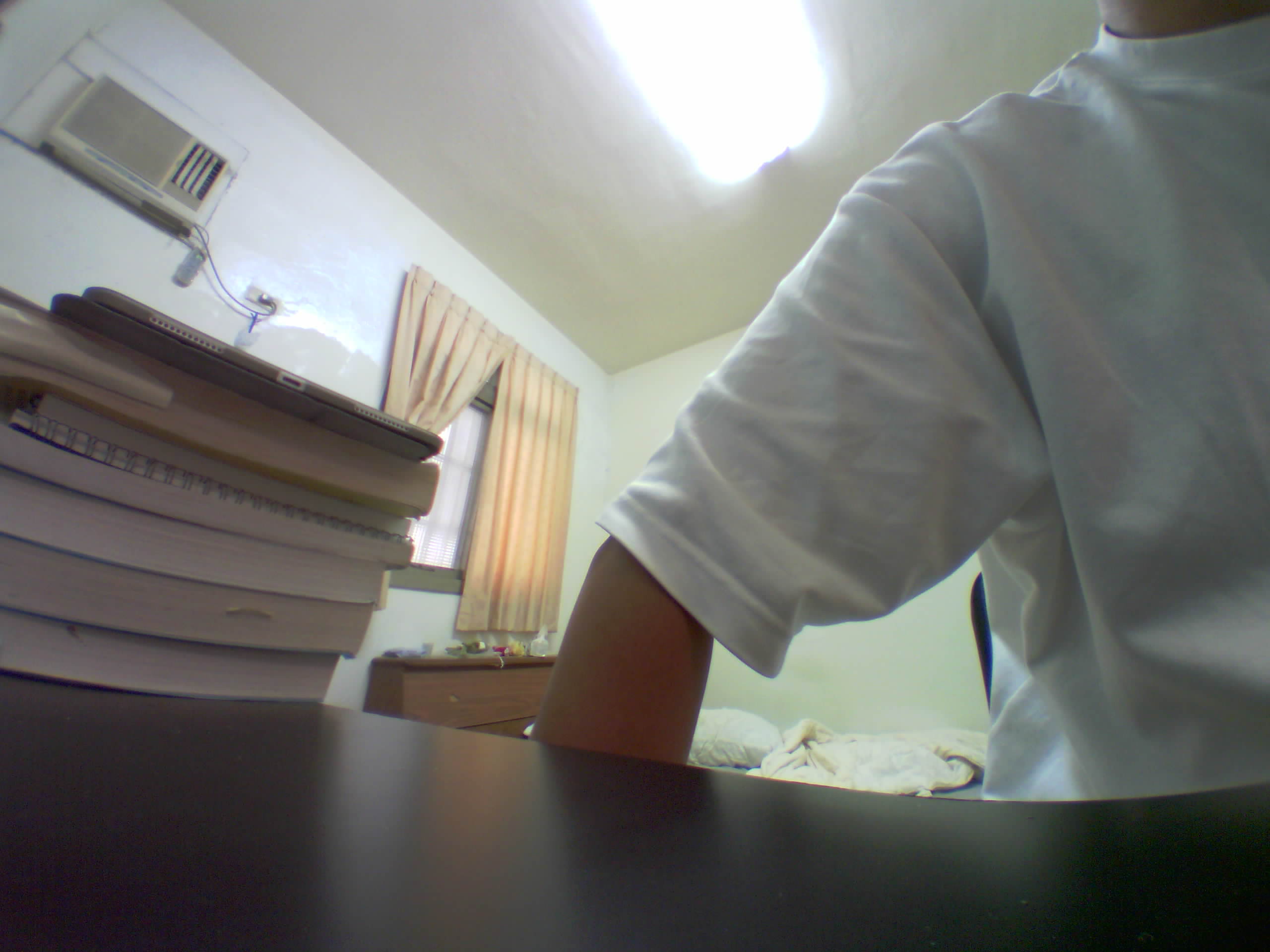

Also I've read that it take some time for the camera to do white balancing so I added some delay during the image buffering loop.
for (int i = 0; i < 5; i++) {
    fb = esp_camera_fb_get();
    esp_camera_fb_return(fb);
    fb = NULL;
    delay(400);
However I'm still getting some quality worsening by each picture taken. (I did realize the saturation was a bit low with this image series and I did set it to 1 later)
Are these also related to white balance? It's just so weired that it gotten worse pic by pic, and I try to do the entire initCamera in the loop it doesn't work either.
