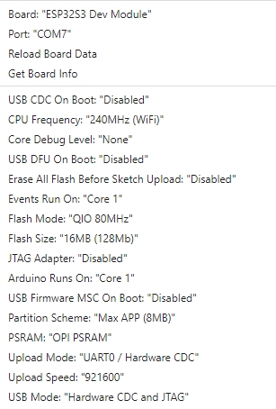

@grumps I've performed the steps you've mentioned here, but am getting a loop with a memory error.
Is the Guition ESP32-S3-4848040 that you say you are using different than what I have in the Guition ESP32-4848S040?
Did you do anything to install firmware ahead of time? What board did you select in the Arduino IDE? Where did you find the Guiton data pack?
Appreciate your help!

I selected the ESP32S3 Dev Module in the IDE.
I have a load of libraries installed: NTPClient 3.2.1, Arduinojson 6.21.3, ESP32_Display_Panel 0.2.2, ESP32_IO_Expander 0.1.0, GFX Library for Arduino 1.5.2, NTP 1.7, NtpClientLib 3.0.2, TAMC_GT911 1.0.2, TFT_eSPI 2.5.43, Time 1.6.1, WiFiManager 2.0.17, esp-lib-utils 0.1.2, lv_examples 8.1.0, and lvgl 8.3.0.
My other settings are shown here:
Well, now I have figured it out - I needed to change my board settings to match what this person had on your other thread:
Additionally, I needed to ensure that my upload speed was set to 115200.
Then following your steps here (in your comment above):
I now have it working! Thanks for having these threads :slight_smile:

I also have a problem, because in board settings I can set 8MB in partition scheme.
