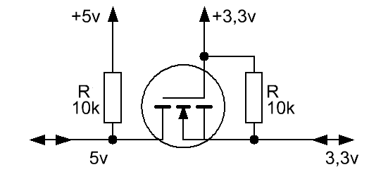

It remains to try level converters

The LCD runs on 5V. The I2C driver ( PCF8574 ) has open drain bus driver, and CMOS logic level input. Assume, the ESP32S3 does the same as master. So I have tied the pull up resistors to 3,3 V.
A quick read of the datasheet reveals that the minimum Vih for the PCF8574 is 0.7V * Vcc. So if it's powered by 5V, it wants to see a minimum 3.5V on SDA and SCL to register a HIGH. What voltage are you seeing on those inputs?
