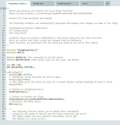

Hi all! Advice Request here:
I am using an esp8266 board to link to Arduino IoT cloud to control an LED via a switch and display the values of a DHT11 temperature sensor. While I am able to control the LED without too much of a problem, I am struggling to integrate the temperature sensor. Specifically, I am able to get the code to compile, but I can't get any value to display on the IoT Dashboard.
Any help would be greatly appreciated, thanks!
(Photos include the code and the Prototype Setup.)

I would suggest removing the delays in the loop(). The loop() function includes the ArduinoCloud.update(); call, which sends data to the cloud and receives updates. In order to get the best responsiveness in your cloud-connected projects, the loop() function should run as fast as possible. This means that no blocking commands should be used inside, and you should prefer a non-blocking programming approach whenever possible.

Hi @spudtech_now
You need to add the temperature variable to the IoT Setup Cloud Variables list as a Float variable.
Then remove the float variable from within your void loop, then the IoT cloud will show your temperature readings .:slightly_smiling_face:

CloudTemperatureSensor temperature
float temperature = dht.readTemperature(true);
You have two variables with the same name, and the local one is shadowing the global cloud variable.

Ok, good news! I think... I have the code able to be uploaded to the IoT dashboard, and it functions on the esp8266 and the Serial Monitor...however, the temperature values and controls don't display on the dashboard. (The last image contains a bit of the ThingProperties.h tab, which I'm thinking might have some errors?) Ideas? Thank you!

General Note to those with a similar problem: It looks like @robrs and @pennam were right on the money - there was a weird error between my thingProperties.h and main tabs, which ultimately ended up being a variable shadowing. There is also another forum post as well that troubleshoots a similar issue.
