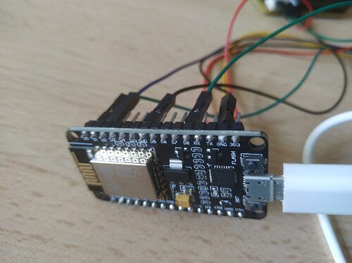

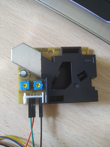

I am doing a project where I have to connect an ESP8266 NodeMcu v1 board (attached photo) and a PPD42 SHINYEI Dust Sensor. Attached photo of the connection. Connection Photo (Black - GND, Red - Vin , Green - PIN D8)

The problem is that in the Serial Monitor I receive: ":+⸮⸮#⸮Rs5U⸮⸮$⸮ "
Anyone have any idea what may be happening?

I've tried changing from 9600 to 115200 and changing the Vin PIN to 3V3, but I keep getting the same output on the Serial Monitor: " ⸮⸮1⸮⸮⸮ ⸮1⸮⸮⸮؁*⸮⸮#⸮⸮)⸮(⸮z⸮3⸮ "

This is a bit a wild guess from my side, because I don’t have any experience at all with a ESP8266 platform.
The sketch uses the D8 pin to read the sensor (using pulseIn to determine the low part of the PWM cycle).
But D8 also carries the RTS signal of the UART0 serial communication (and pin D7 carries the CTS signal).
I don’t know if Serial uses the UART0 hardware, but if that is the case then connecting the sensor to D8 may mess up the Serial communication (or depending on the point of view Serial may mess with the sensor). Then it would be better to connect the sensor to a different pin.
And for my education: in the ESP8266 world, do you refer to a pin as e.g. “8” or as “D8” e.g. in a pinMode statement?

Good morning, now I am using this code:
Connections: (Black - GND, Red - Vin , Green - PIN D5)
int pin = 5;

I receive as output:
I think the problem is that the sensor is not turned on. I use the micro-usb with the PC to power the board
Maybe I have to set the Vin pin as 5V output? If so, how should I do it?
If you connect to the D5 pin, you should write
int pin=D5;
Guy
