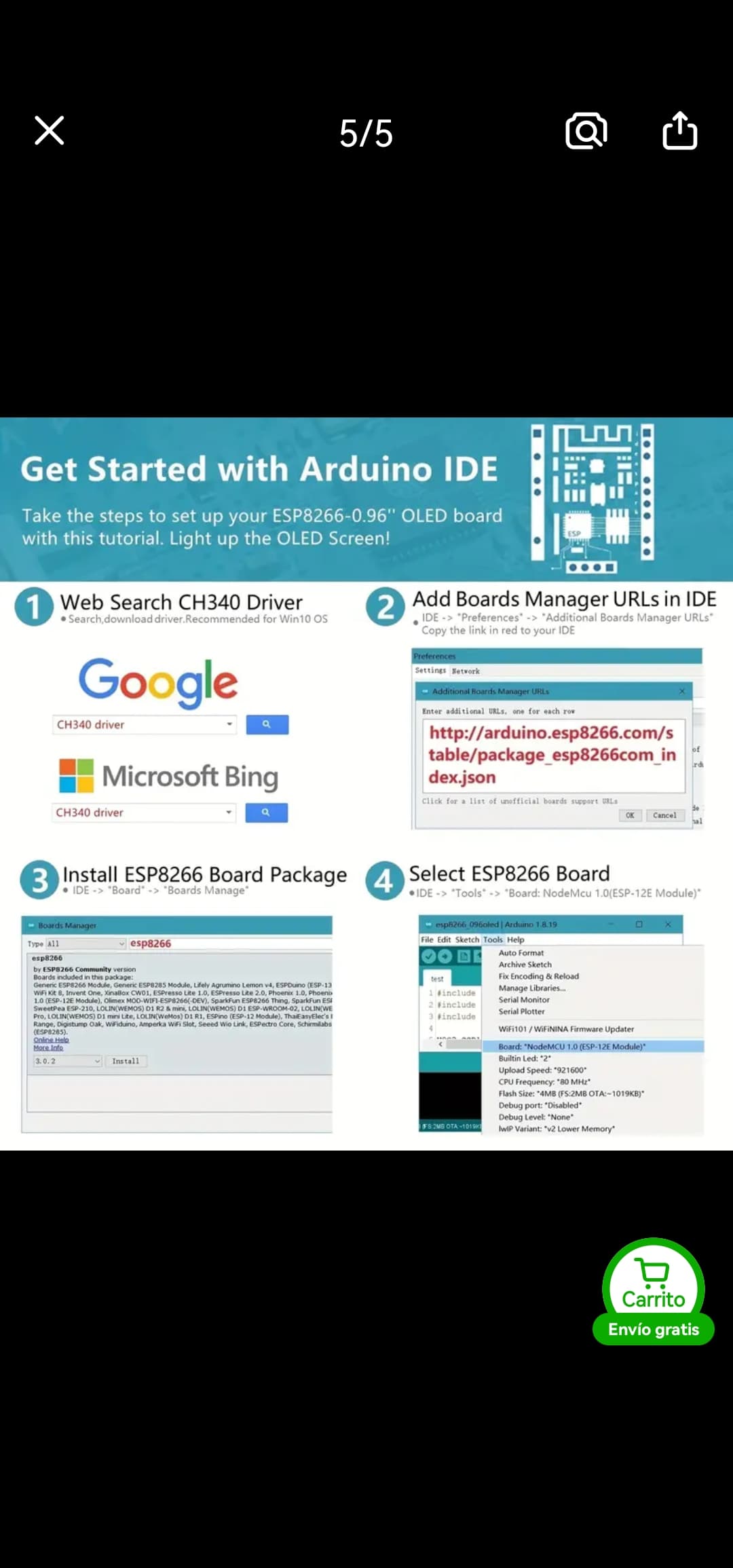

PD3: I'll also leave two photos from a seller to make it work, in case it's useful for you (the seller I bought it from didn't actually include those)
Well, to close this topic, i dont actually know why this particular code works, so dont ask me hahaha, its up to you to study it, but its certainly a relief to know the screen is not dead, it was all a matter of faith
