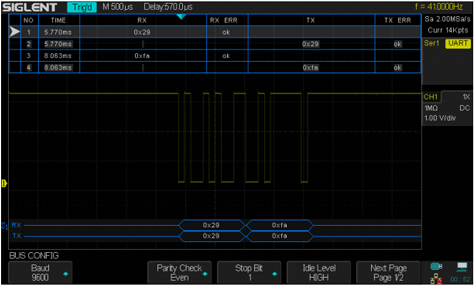

If I were you, I'd use an oscilloscope to check the comm lines:
UART would something like this look like this (applicable to both rx and tx lines):
