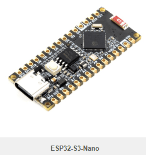

External antenna in ESP32-S3-Nano
Maybe someone can tell me.,
where should I solder the external antenna in the ESP32-S3-Nano board?
Is that board supposed to have an external antenna connector ?
There is no connector for the antenna, is there a way to connect it somewhere ?
solder it with a cable..

The red part is the aerial.
It is soldered to the board on two sides, but one side is likely a dummy pad (not connected to anything). Swipe off the red part with a soldering iron.
Solder the core of the coax of the external aerial to the pad that is not the dummy pad.
Scrape the paint off a small area of the ground plane next to the red part, and solder the shield of the coax to that.

The trick with these high frequencies (2.4GHz) is to keep connections short.
