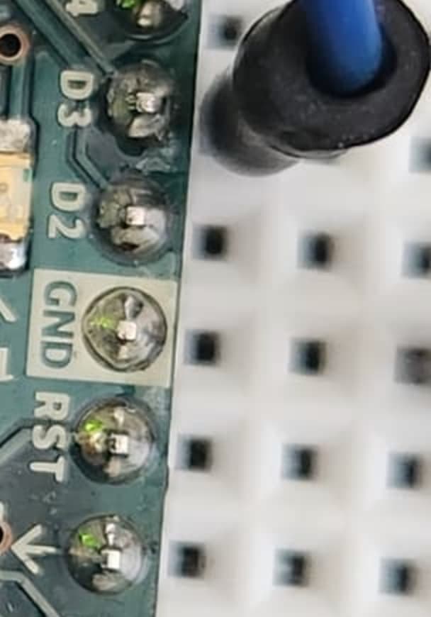

In that picture, you are plugged into D3 or INT1. That is a NANO right?
Your wiring must be incorrect, but it is impossible to see the mistake from the photo. Post a hand drawn wiring diagram, with pins and connections clearly labeled.
In the picture, that is plugged into D3, which is, for whatever reason, tied to INT0. Yes, it's a Nano, bought from that link above.
Your solder work looks a bit sketchy. Whaty temp are you using, what kind of solder?

Have you used a soldering iron on any of those pins in the picture?
Along with your hand drawn wiring diagram, please post all the code, using code tags, and describe or post a link to the electronics module connected to D2 and D3. Did you connect all the grounds?
Post a pic without the blue and yellow wires obscuring the view of the MCU IC so we can see which PCB trace is going to which IC pin.

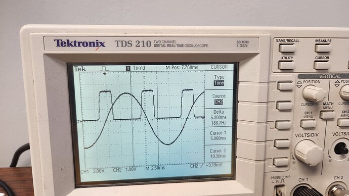

I'm using a function generator to create the 60Hz 5Vac signal.
The "square wave" is what's being sent to D3 currently from the H11A1:
