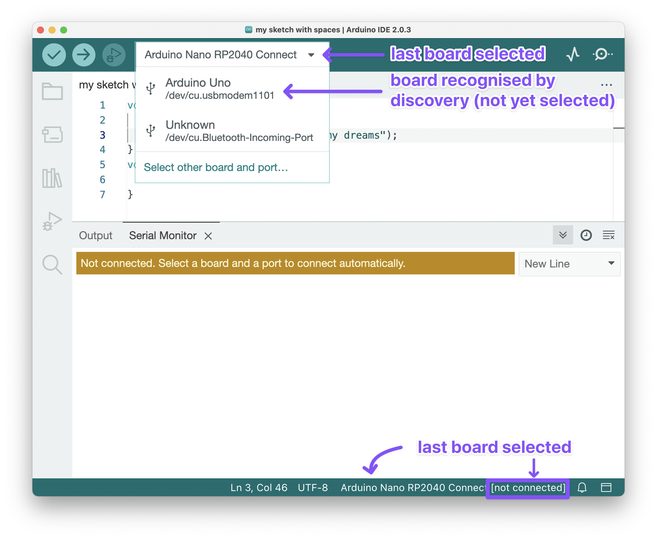

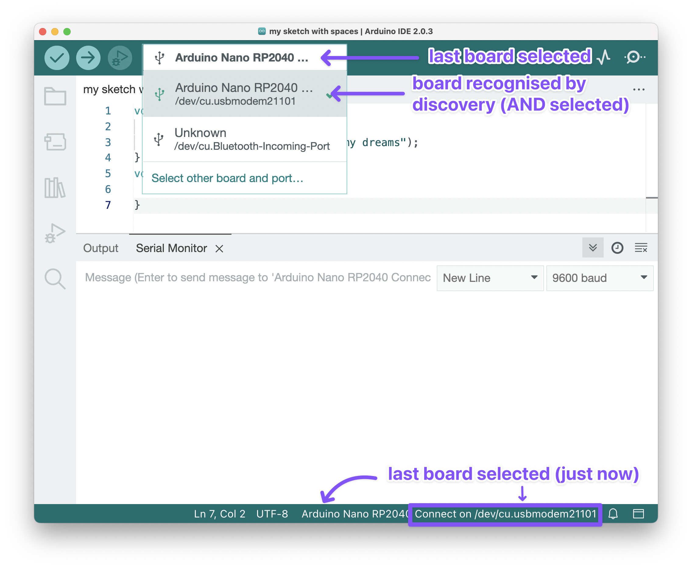

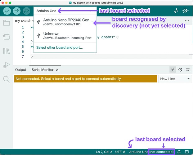

you are failing to understand what the UI shows:
Nano RP2040 Connect board connected to USB port, but user last selected Arduino UNO for that Sketch.
Bottom-right such last device is displayed: IDE "remembers"
Selecting the board disovered and displayed in the drop-down will result in this situation.
Bottom-right displays "on /SERIAL/PORT/RESOURCE"
Close the IDE.
Disconnect Nano RP2040, connect UNO, reopen IDE
Last board selected (Nano RP2040) is displayed both in menu and bottom-right
UNO is displayed as available (discovered)
