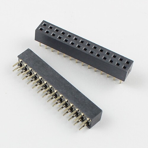

I want to stack the i2c lcd module and lcd 1602 together. Both have male headers soldered.
Sorry, I was not clear. Currently, I'm using a mini breadboard. I could have used a ribbon cable. But what I want is a gender changer to stack the devices together one on top each other.
You could fab your own by soldering two of these back to back.
I'd use double row connectors and solder both rows for the structural stability.
That's a good idea. Now time to politely ask the school technician to build 30 gender-changer.
Have him teach you. It's a good starter project.
If you decide to go that route, I suggest you use the surface mount version for easier soldering.
