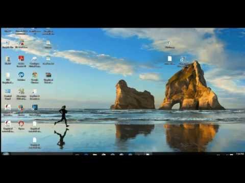

Here is the video how the Arduino working inside Proteus reading/writing SDcard...The files are actually generated and written though its a simulation...
With SD library Proteus works fine now with MMC...I wonder someone now hack SDFat to work with Proteus...I am Not a good programmer...
