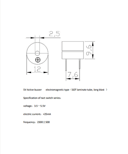

Edit: The datasheet for my buzzer is attached below. as you can see it is pretty minimal, but it says to only run on 5.5V maximum
You will not get 100db out of that tiny buzzer.
Anyway you can try it manually connecting directly to 5V and GND.
I know I won't get 100db out of the buzzer, I made this post to query if anyone had any experience with a loud buzzer in the past, so I know what I'm buying isn't a dud. I don't have any smoke alarms handy, so I'm just trying to purchase a loud buzzer online.
I measured the sound level from around 10cm away and got 80db. I need the buzzer to be loud because the device is diagnostics for a water tank in a factory. If the water tank overflows and the alarm isn't loud enough, the tank will flood the factory floor, which I think has happened a few times..
Also, since it is a magnetic buzzer, it starts producing sound as soon as a DC voltage is applied to it. If I connect it directly to 5V and GND then it would produce a continuous sound, which I cannot use.
