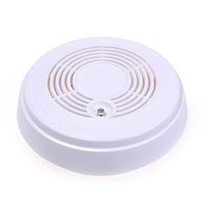

My segway is powered by 24V, but I only have 5 volt coming onto my control board (supply from Sabertooth motor driver). I'm hoping to find one that is loud enough, but is PCB mountable, I like cutting out extra wires anytime I can.
It will, however be in a plastic enclosure, at my feet, like this:
