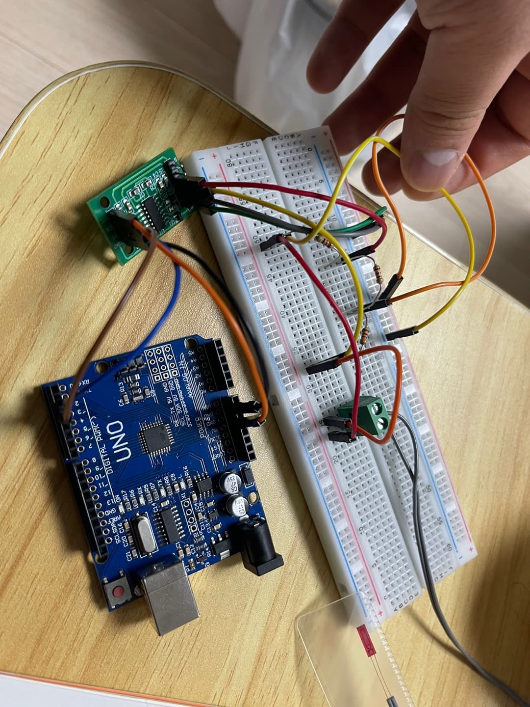

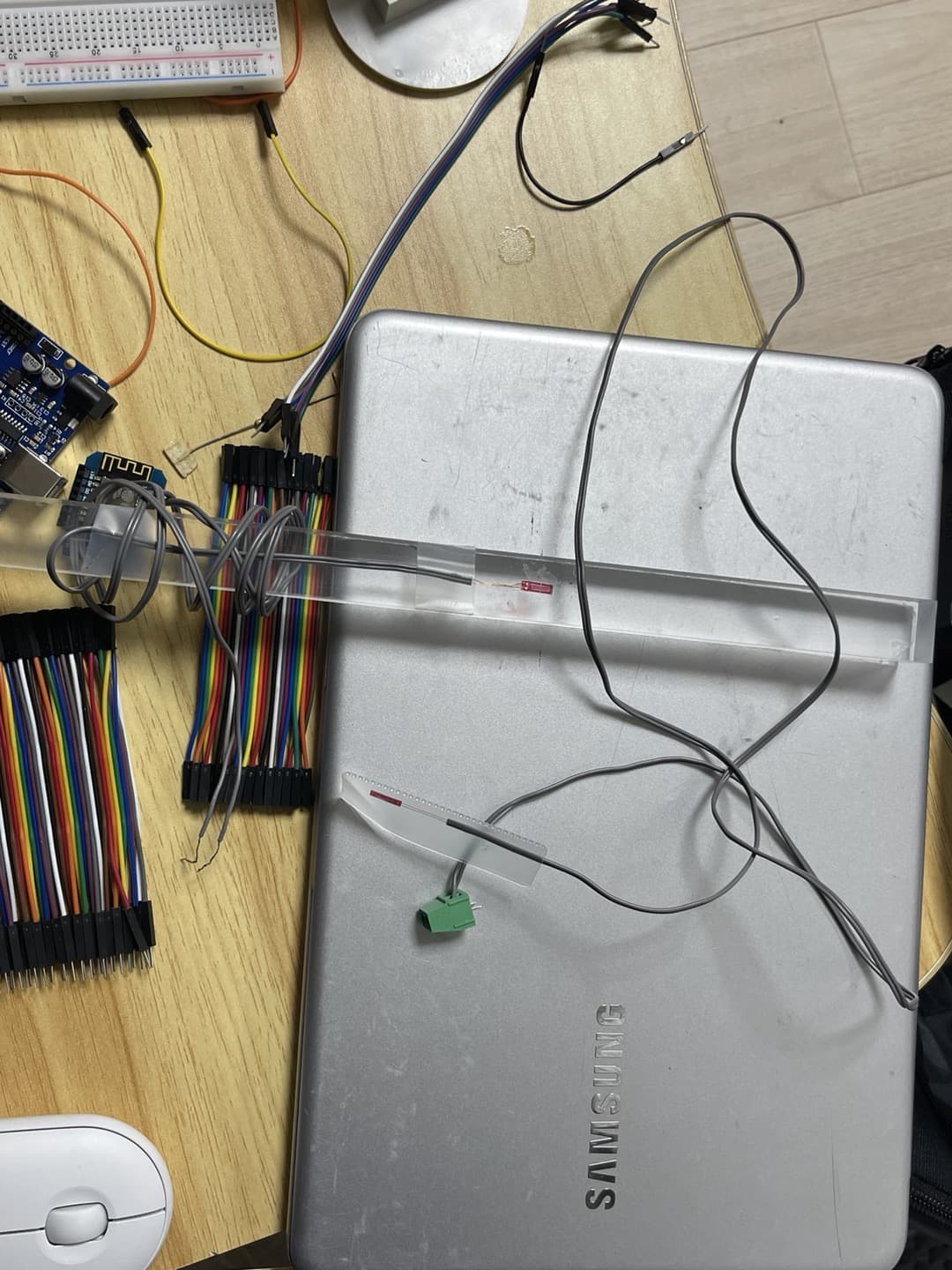

When calculating the deflection of a simply supported beam using Arduino ESP8266 and HX711 amplifier, three resistors of 120 ohms, and one strain gauge with a resistance of 120 ohms.
I'm trying to make a stem.
The problem I currently have is that the sensor value only shows -1 or 0.
It is not possible to calculate the slight deflection of a solid wooden bar by amplifying the signal using the HX711 amplifier.
I expect there will be no problem with modifying the signal terminal to match the code and reinstalling it.
The HX711 library used was created by Rob tillaart, and we expect there will be no problems.
The code to use is also very simple, so I don't expect any problems.

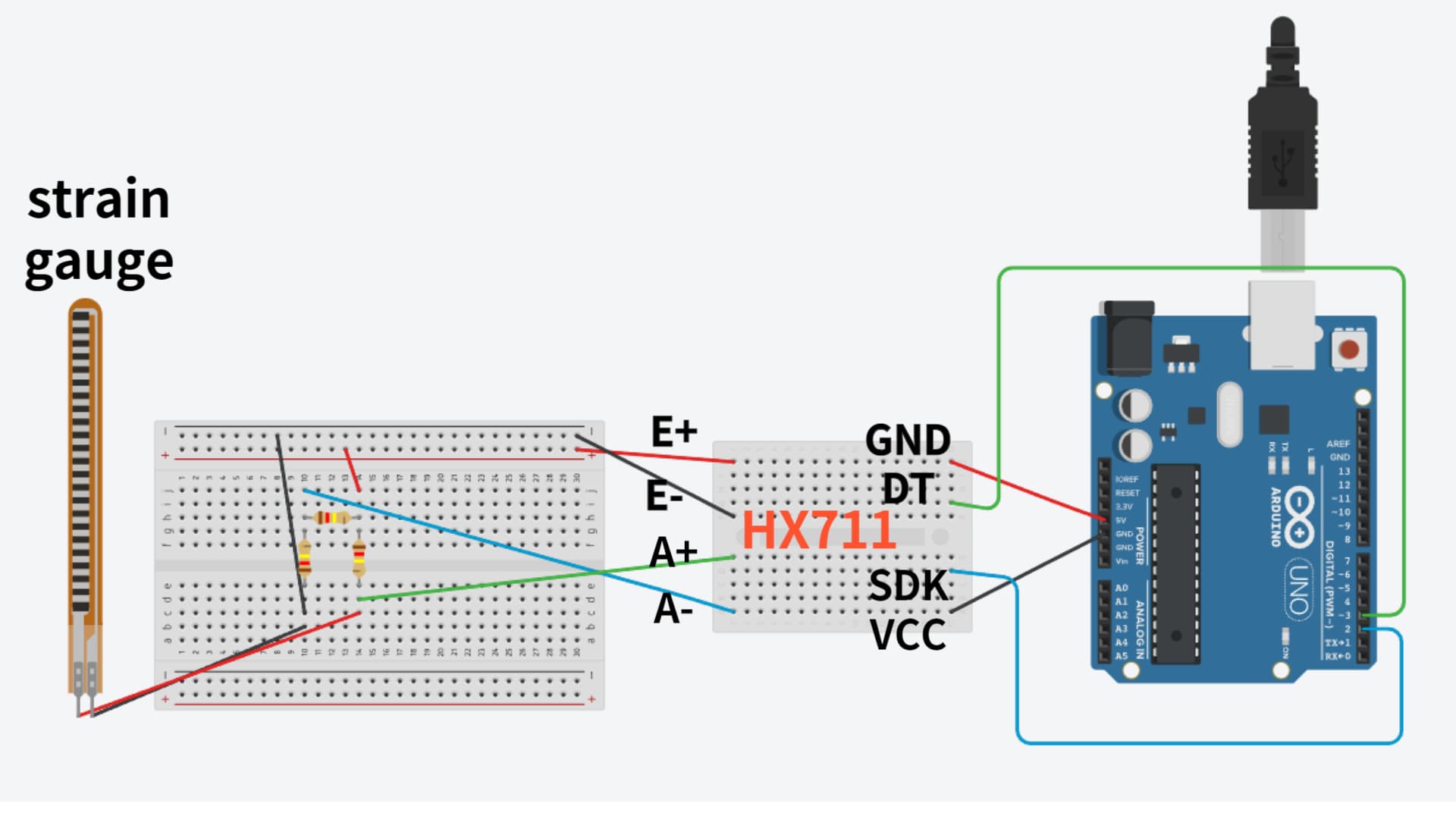

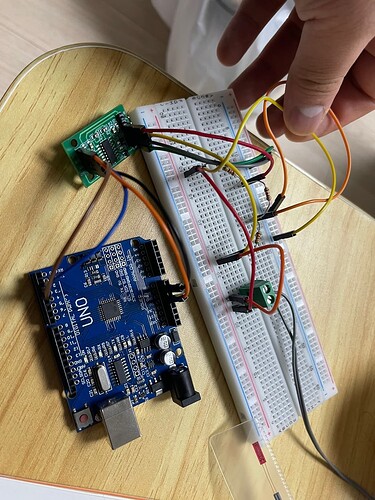

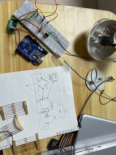

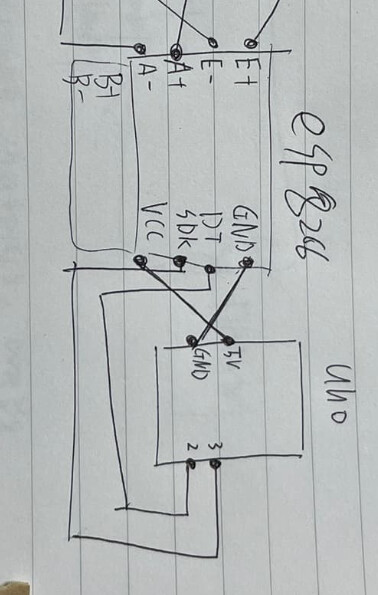

I will attach the actual circuit and circuit structure diagram.
There is no proper data for the structural diagram, so I would like to ask you to check the actual photo.
I would really appreciate your help.

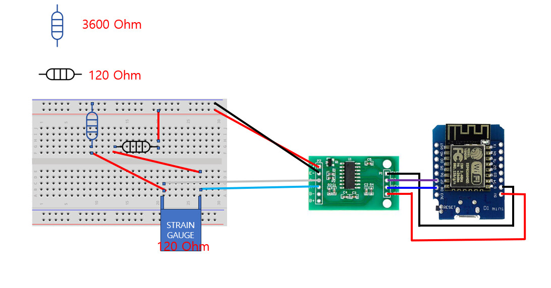

Your code shows D6 and D7 as the pins connected to the 711, but your Fritzy image show pins 2 and 3.
Why all the ** ** ** ** in your code?
It will not compile.
Thanks.. Tom.. :grinning: :+1: :coffee: :australia:

Those look like 5% resistors, which may not be accurate enough to produce a signal in the +/-20mV range of the HX711's inputs.

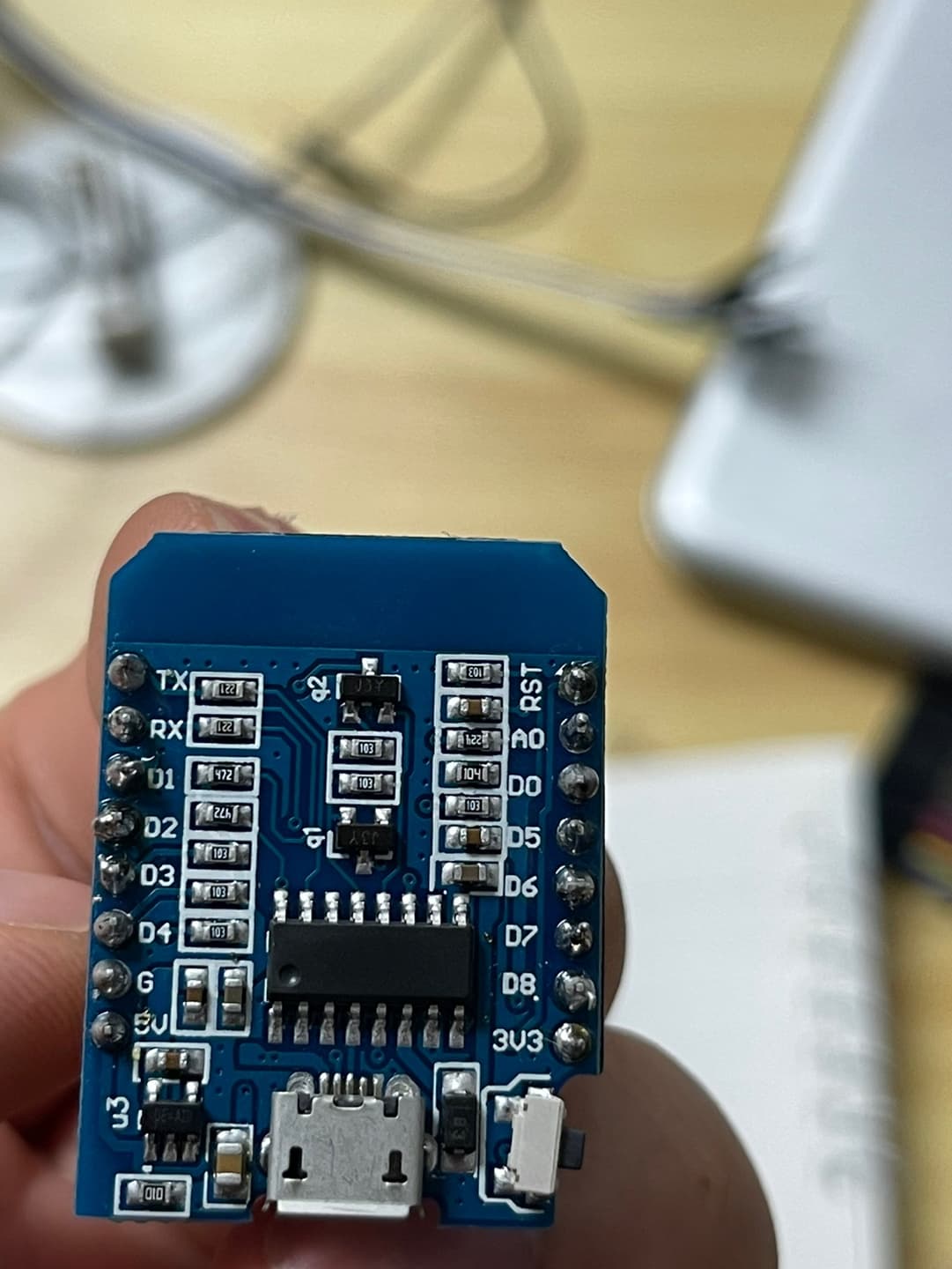

I currently have two boards: Arduino UNO and ESP8266 (WIFI model).
For the circuit diagram, there were no pictures of the ESP8266, so I had to use a picture of the UNO board.
So, I think the reason it has a number like D1 is because it is tested using two boards.
There will be no problems with the code because the code is modified each time the board is used alternately.

... and actual measurements of the wheatstone bridge resistances & voltage difference going into the HX711.
Yes -- If your wheatstone bridge isn't balanced well, the output to the HX711 will peg to one end of the range, and then screw up any tare or calibration operations.

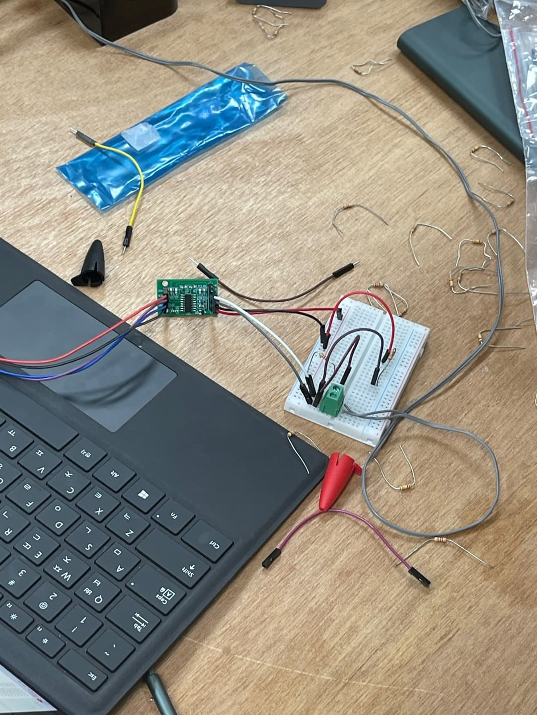

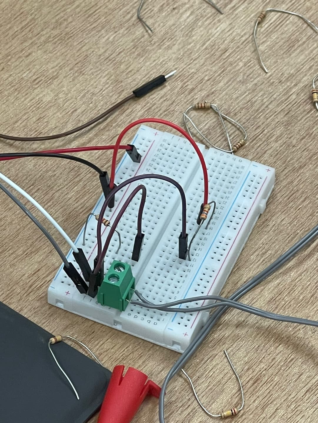

I apologize for the messy wiring of the actual circuit.
ESP8266
After testing again using both ESP8266 and UNO boards, only 0 is displayed on the serial monitor.

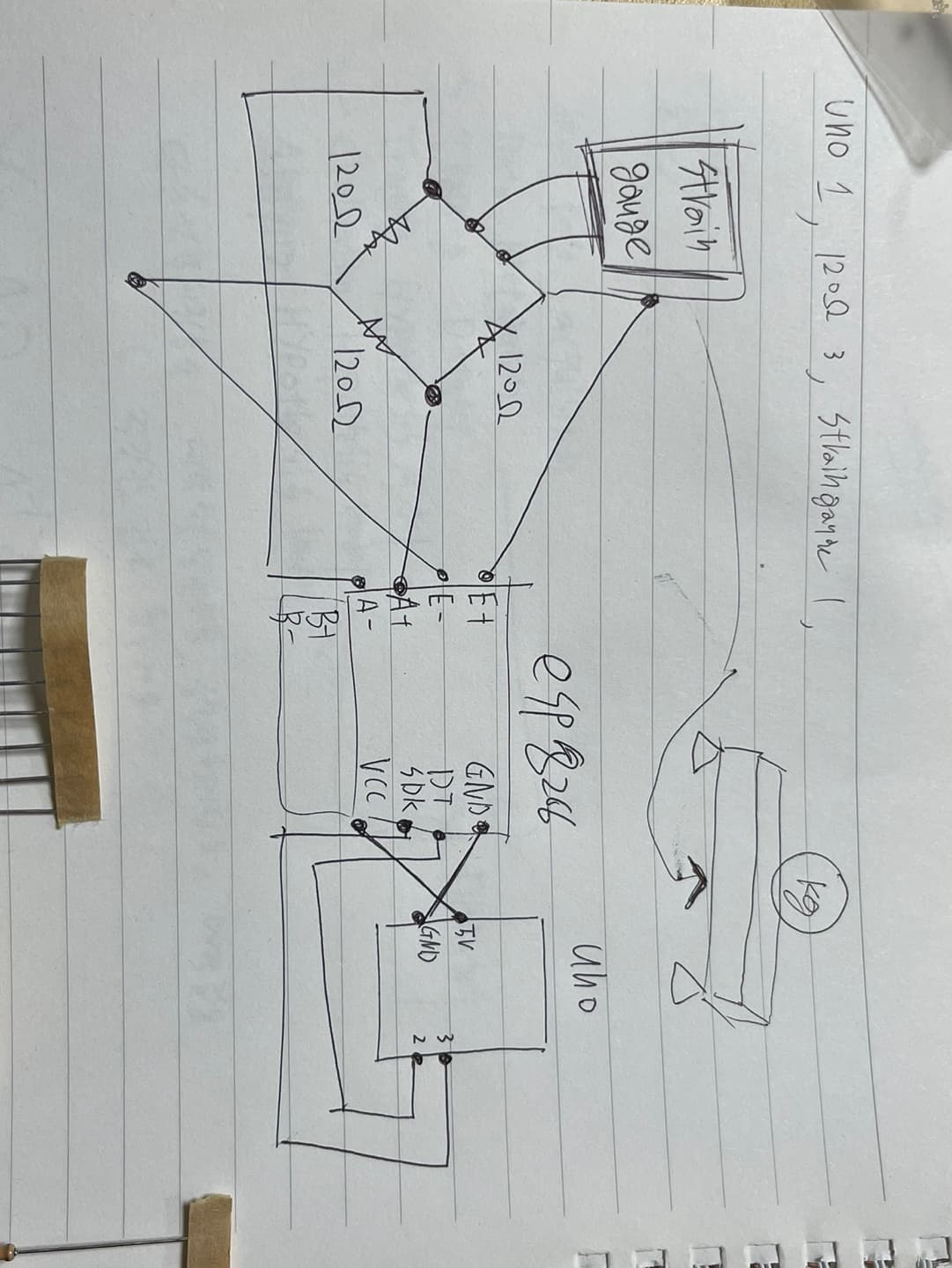

If I need to reconfigure the circuit, I'm willing to start from scratch.
@DaveX
The currently uploaded photo doesn't look good, but can you give me some advice on what improvements should be made to the current circuit so that it can be measured clearly?
I am a student majoring in ship and marine engineering, not electronic engineering, so my understanding of circuits is very limited.

Are the 120 ohm resistors actually 120 ohms? If they are off by 5%, the Wheatstone bridge output millivolts into the HX711's A+/A- could exceed the +/-20mV, pegging the readings to a constant value at the limits, whnich, if tare()-ed would produce readings of 0.
Use a DMM and measure the A+/A- voltatge to see if it is in the +/-20mV range. If it isn't in range, pull each resistor, measure its exact resistance (and also the resistance of the strain gauge)
If one resistance is 126 ohms and all the rest are 120, then for a 5V E+/E- you'd get 5*(120/240 - (120/(126+120)))=60mV The resistances all need to be better than 120.0+/-1.0 to move the A+/- voltage down to the 10mV level.

It has a resistance of 120 ohms and a resistance of 3600 ohms, so you can plug in additional resistors if necessary.

Does this diagram match your code?
There might be something wrong in the connections of the working circuit to your device versus its connections to your professor's device.

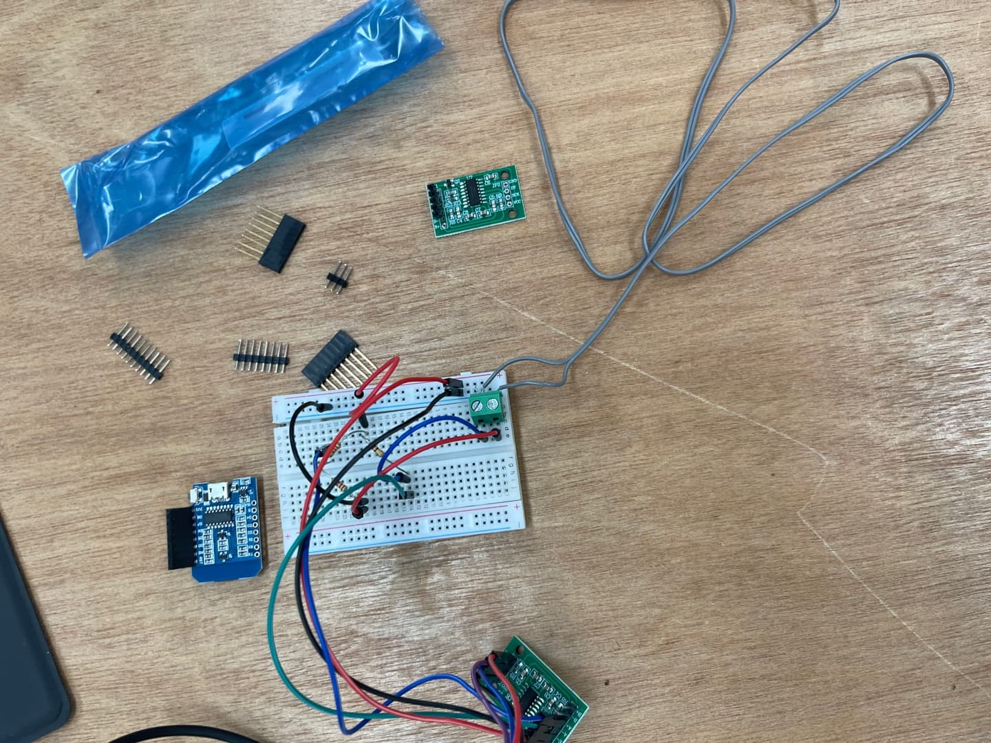

First of all, I really appreciate your help until late.
While searching for information at school, I found something that might be helpful.
In the case of the photo, it is a completed version of the project and is a photo of a circuit designed by the professor and only possessed by the professor to calculate deflection.
I also saw a demonstration, and the code below is the code the professor used.
I don't know what it means due to my lack of electrical engineering knowledge, but I disassembled the existing circuit and connected it to the structure in the photo.
Only 0 is still displayed on the serial monitor.
I searched for data and did preliminary research on various cases, but there is a problem with the sensor values, and the situation is not working for all of the 20 students working on the project, and only the professor is involved, so I honestly don't know what the problem is.
