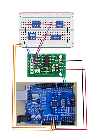

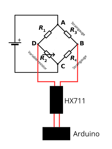

  1. For the sequence as follows, please correct if there are errors. Sorry if it's confusing, this is the best I could draw.
  1. How do you install this 3296W variable resistor into the Wheatstone bridge circuit? there are 3 pins and I don't know where to put them.

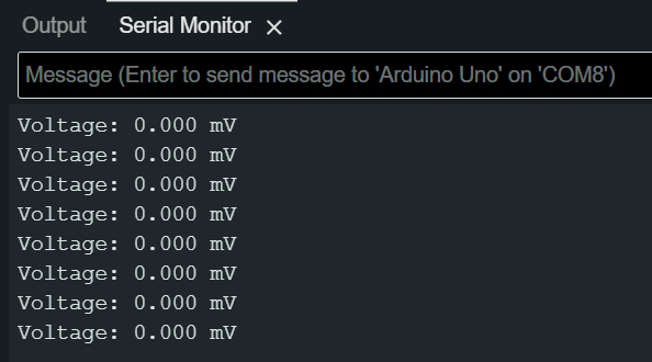

  2. For the program library, I use the HX711 library made by Bogdan Necula and the program code made by ChatGPT as follows, but the results are always like in the following picture:

Screenshot 2024-06-11 145821
I don't understand what part is wrong, please help because the deadline is coming up :') thank you very much!

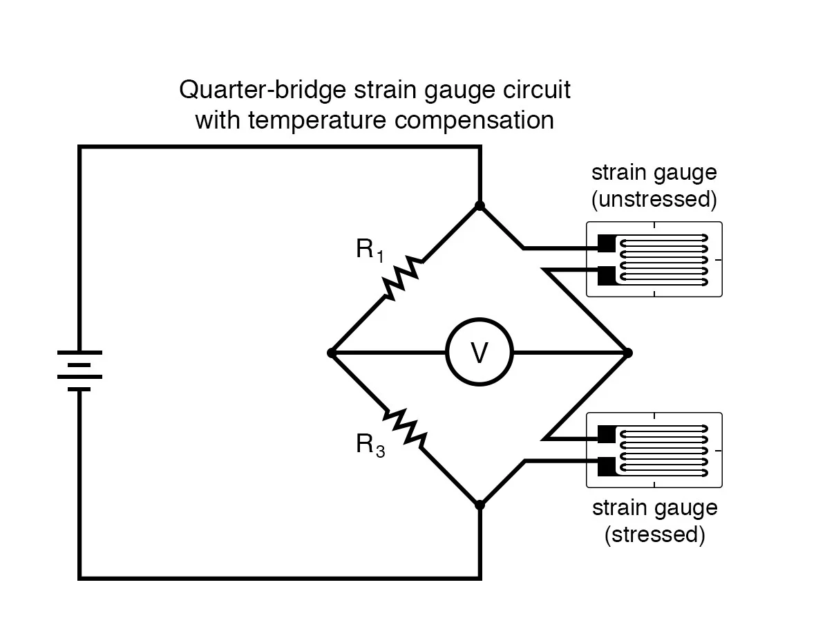

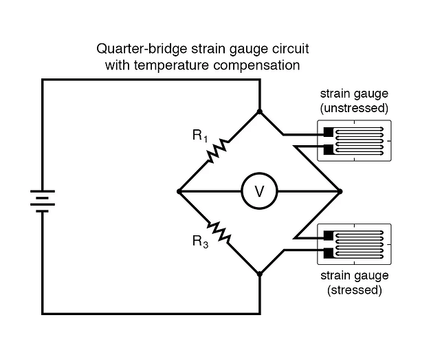

Well maybe since this is school work you could ask ChatGPT what's wrong? Do you understand strain gauges and strain gauge bridges? The variable resistor is likely there to zero the bridge. I am guessing 120 Ohm strain gauges. This is what you have less the pot.
I suggest you read up on and understand strain gauges.
Why do you have E+ and E- configured as you do? The E is bridge excitation. Find drawings using the HX711 and get your wiring correct. That's just for starters.
Ron
The Wheatstone bride should only be powered from E+ E-
So remove the red/yellow wires at the left of the second diagram.
Make sure the bridge is balanced, with less than ~20mV between A+ A-
