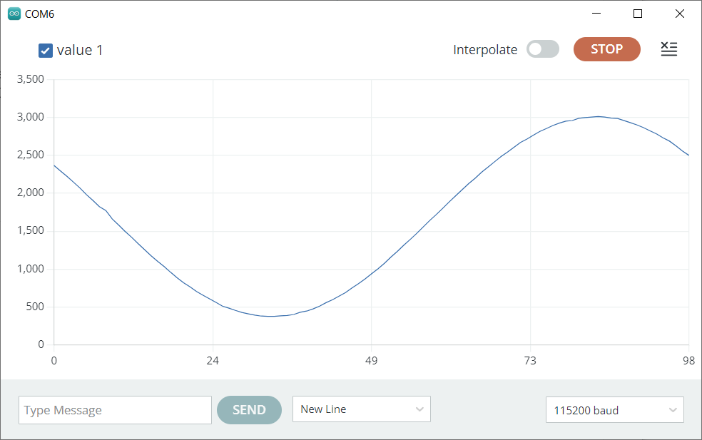

experiment measuring the rise time of a 10Hz sine wave
ESP32 sampling every milliSecond
// ESP32 determine sine wave rise time
// the data acquired must be the rising edge of signal - see example sine wave plot

Serial plotter output
serial monitor output gives a rise time of 30mSec

minSample 34 min 372 0.299707V
maxSample 84 max 3007 2.422632V
ampliude 2635
rise start 635 rise end 2744
rise time 30mSec

void falling() {
  attachInterrupt(PB0, rising, RISING);
  pwm_value = micros() - prev_time;
  //Serial.println(pwm_value);
on ESP32 serial monitor displays
50002
voltage 2.505615
50002
voltage 2.524951
Thanks. It was crashing because of the Serial.printf("voltage %f\n", voltage);
maybe on execution it crashes there. Changed the printf to println and removed 'voltage %f\n' and it worked and gives both the pwm and the voltage. Amazing!
