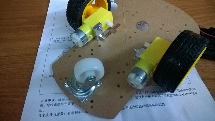

I've been buying a few cheap pieces off eBay and using what I had around to finally get going with my first robotic project.
After viewing several videos and tutorials I decided to use a L293D chip from a motor controller board I had bought as it allowed more freedom with spare pins as I only needed to control two DC motors.
The first two images show the cheap robotic base I bought from China for £7. It has two 6V DC motors.
On the second two images it shows the full robot that I made. It is being powered by a 9.6v rechargeable pack for a remote control car. This is going through a voltage regulator to put out 5V for the motors. I know that this is not the best way but is certainly the quickest for me to have something working.

Now I have a few main issues that hopefully are easy to get over.
Firstly when I was testing all the controls with the robot sitting on a stand so the wheels would spin without it shooting off I would find a couple of things. Sometimes when you set it to go forwards (both wheels travelling at the same time) only one wheel would start up and run at around half speed. If I set it to loop through a couple of commands and run the forward again it ran fine. :frowning:
Secondly on one of the motors I was unable to get it to run in reverse. This was on pins D1 / D2 where it was as if D1 would go LOW but D2 would not go to HIGH.
Thirdly I also tried to use PWM on pins D10 / D11 to vary the speed of the motors. Sometimes this would work and other times this would not. The code shows everything as digitalWrite but for the leftMotor and rightMotor on pins D10 / D11 these were written as the proper analogWrite so the code is not a mistake just how it was changed to work.
Lastly when I set the robot off on the floor with a simple go forwards and if the sensor picked something up within 50cm do a left turn it all worked fine except that the robot had a slightly quicker drive on the right motor. This results in the robot doing a slight left turn where had it got the space would probably run around in a 3 or 4 meter wide circle.
I'm not sure if these are related to the power I'm using to drive the motors as I'm using a 5V regulator. I'm sure that some of these can easily be resolved.

First, don't use a voltage regulator on your motors. That's like towing a car with a piece of string. It works, but you can go faster.
Your motor drivers will regulate the voltage to the motor. If they are 5v motors and you have a 9v battery, then you probably shouldn't exceed 60% drive except for short periods. Check if the motors are getting hot after a long drive and then turn this limit up or down in your software.
Second, how is the Arduino powered? Is it connected directly to 9v or is it sharing the motors' 5v? Sharing is bad. Connect the Arduino's Vin to 9v.
I suggested to the Moderator to merge the other Thread with this one and then he did it and I lost my reply .....
I presume you are using DC motors (and not stepper motors).
The L293 will have a considerable voltage drop - it's probably better to power it directly from the batteries
A PP3 type of 9v battery cannot provide enough current and runs flat very quickly. Use AA NiMh batteries or just use a trailing power cord while testing.
Draw a diagram showing how everything is connected and post a photo of the drawing. Drawings are easier to figure out than photos of hardware.

That looks like a pretty good 9.6v battery in the photos. I think the OP is on the right track.
From the original post
To allow the robot to roam without any trailing cables the UNO is being powered by a rechargeable 9V battery.
I don't think this refers to the 9.6v battery.

Langy:
Intermittent issues like that can often be loose wiring. If it starts acting up like that in the future, try pushing and moving some of the wires to see if it corrects the behavior. Those jumper wires and breadboards are real handy and easy to work with, but they don't always make the best connections. I've had bad jumper wires where the wire is not properly connected to the pin: it gives poor performance, and then the pin and plastic covering falls off of the wire. >:(
I've also had it where the pin on the jumper wire doesn't make good connection with the breadboard, even though the jumper wire and breadboard are new: just moving the wire a bit causes it to make or break the connection.
Again, check your connections, and double check that everything is going to the right pins. The D2 line looks like it's hooked up properly in the picture, but it's so hard to tell on a picture.
Try putting an LED (with a dropping resistor) on that pin and see if you can make it change. It's possible that the pin circuit in the chip has become damaged and can no longer drive it properly. It's also possible that the pin on the motor controller chip is bad, as well. Take the D2 end of the jumper wire and temporarily connect it to ground and then 5V and see if the motor controller responds properly.

L293D and other darlington drivers lose 2.5 to 3V already, so you definitely shouldn't
regulate the 9.6V down at all - straight to the L293D motor supply, and with luck you'll get
7V max to the motors, no problem since you can limit the PWM as you see fit.
Regulating down to 5V would mean only about 2.5V to the motors, 70% of your power
wasted....

As it's been said, don't power you motors thro' a regulater, your motors will need more current then it can supply. I now never use the L293/98 has you lose 2v+ on the output so you're 5v to the motors might be 3v, give the motors the full battery voltage. 9.6v-2v=7.6 should be OK with them motors (6v)..
Don't use pins 0 or 1 as they are used for serial I/O and programming. PWM works differently for different motors! I find that any value under 50 does'nt move the motors at all.
Check all wiring and let us see a schematic... It's very unusual to buy two motors that run at the same speed, use PWM to even this out by runiing the slower motor, with an higher value, you'll have to experiment a bit to get it right.
