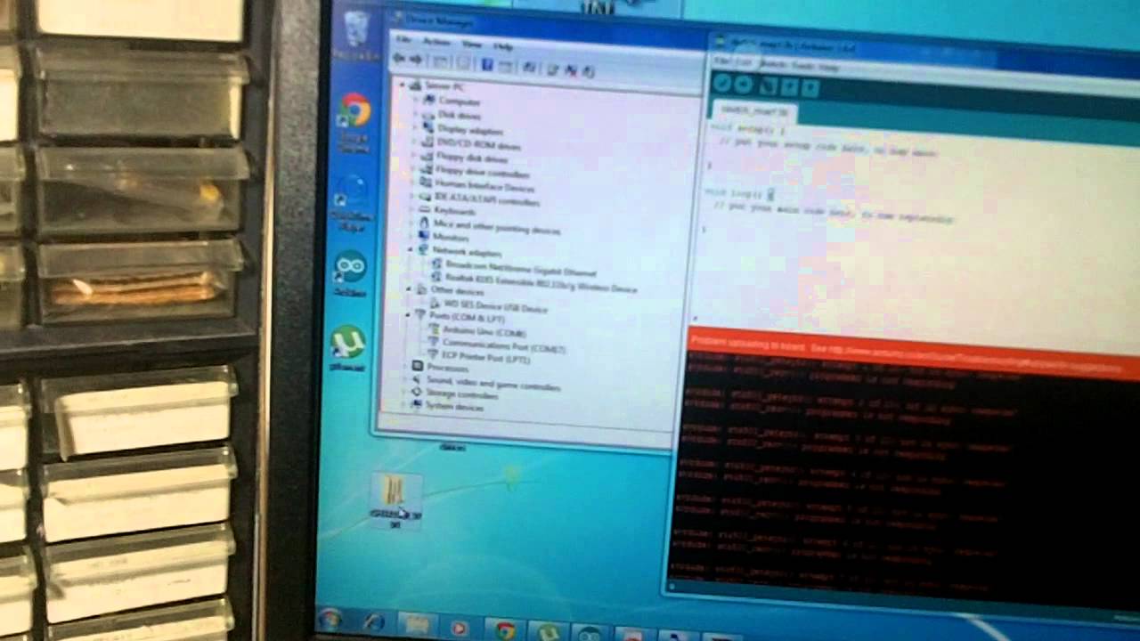

IF you have purchased an arduino form Ebay or ali express or other mass merchant online store then your arduino might be bootleged. IF your OS doesn't automatically install the driver for arduino and manual installation returns "This device cannot start. (Code 10)" then the USB to Serial chip on your arduino is different from the one used on trhe official arduinos (ones tha cost a quite bit). This tutorials shows you the steps you have taken and steps you must take to reverse your previous installation + isntalling the actual arduino USB to Serial Chip driver.
