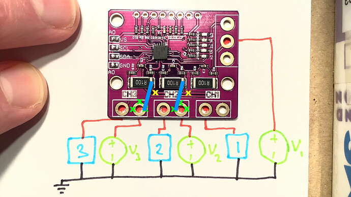

I was reading about the INA3221 breakout board in this thread INA3221 breakout board - Sensors - Arduino Forum . Channels 1, 2 and 3 are connected respectively to In-1, In-2 and In-3 pins of the INA3221. In+1, In+2 and In+3 are connected together to POW pin.
So I tried to fix the board by cutting the traces connecting one side of the 3 shunt resistors to the POW pin, then I cut all the traces connecting the GND input pins to ground then I resoldered some wires between each shunt and the input pins. By analogy to the INA219, GND input became the V+ (connected to power supply), the Channel input became V- (connected to load +).
I tried the 3 channels and now they work independently with 3 independent power rails with connected grounds

I haven't tried this yet but just looking at the images something looks odd to me... Shouldn't there be another cut?
I've marked the trace that I'm talking about with a green circle:

It may be easier to just solder a short piece of wire onto the right sides of the shunt resistors, and use those as inputs.
You still need to cut the path that runs between the right sides of these resistors. (so that's two cuts in total, no more)
By the way, there's no need to make a new connection between the left sides of the shunt resistors and the input connectors CH1/CH2/CH3; they're already connected.

For any one who has recently bought this board, you only need to add two new links and make a few breakages to get things working with three supplies as shown in this image. From this explanatory video: INA3221 Breakout Modified to Take 3 Independent Voltages - Tutorial - YouTube
Hi R11K, thanks by the help, however I found the GND connection in the bottom side in my board, so It should be cutted also too, right? Thanks in advance!
Yes, if you want to repurpose the ground connectors as connections to the shunt resistors as in the diagram you need to cut the connections to the ground planes on BOTH sides of the board. That’s six tiny connections per ground terminal :grin:
