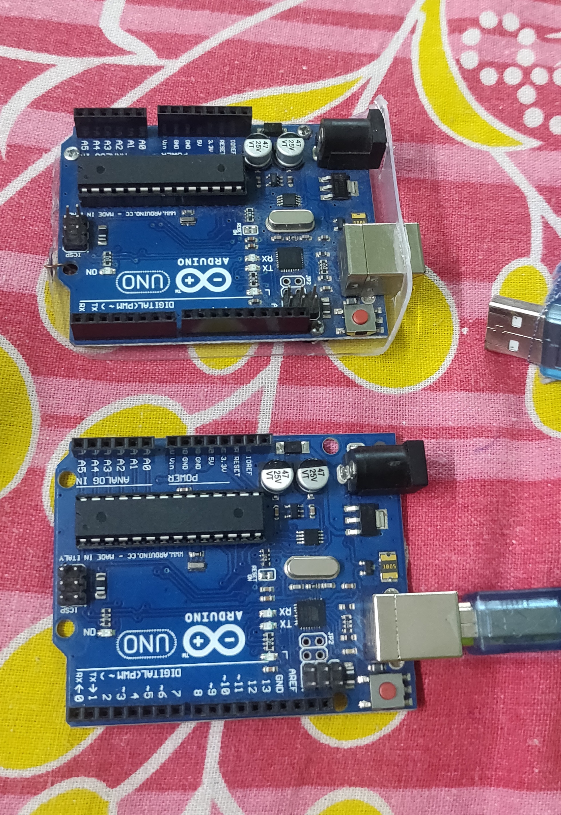

FLASH BOOTLOADER OF ADRUINO UNO HAVING ATMEGA328P USING ANOTHER ADRUINO OF SAME
I HAVE TWO ADRUINO UNO HAVING ATMEGA328P, PLEASE GIVE TUTORIAL ON HOW TO CONNECT THEM
AS MASTER AND SLAVE TO FLASH BOOTLOADER OF THE ATMEGA CHIP OF ONE ADRUINO USING
ANOTHER. THANX

Arduino: 1.8.5 (Windows 10), Board: "Arduino/Genuino Uno"
avrdude: Yikes! Invalid device signature.
Double check connections and try again, or use -F to override
this check.
Error while burning bootloader.
This report would have more information with
"Show verbose output during compilation"
option enabled in File -> Preferences.
this error is coming

*So, above is the verbose output now please tell what to do.
Triple check all your wiring. I get the "avrdude: Device signature = 0x000000" when I have my wires incorrect or don't have the target board powered.
Yes I checked 2-3 times same thing is happening.
Should I give external power to the target board?
If you have the 5V and GND pins connected, then the target board will be powered by the programmer board, so there is no need for an external power source.

I also changed the signature for atmega328p as shown in some tutorials but still not working.
I think I have to buy a new one.
If someone has any confirmed video tutorial please share, would be of great help.
This is not a problem of signature nor -F to override will not work. All zeros means that there is no connection to the target. No response at all. The question is: Why?
The wiring problem is 90% of cases on forum by raw estimation. However, there can be other reasons like trivial one - bad USB cable. You have to go throughout all your setup.

    Check the LEDs behavior on the programmer Arduino. You should see short 3 flashes on Rx, cca 1s interval between them. It is prompt from programming tool received in the programmer Arduino.
    If you have DMM (multimeter) you can check voltages on target's pins. The power of course, but also RESET pin.
    The RESET should be high (VCC) in idle state but as soon as the programming process starts it should drop to GND for a moment due to reset pulse. It is observable by DMM.
    But first, check carefully 6 wires between Arduinos.
Another thing. Is your target board OK? You can check it by replacing the chip from working one.

The problem is with board.
Maybe somehow the chip got damaged.
Yo mean ATmega chip? It is not problem to replace by a new one.
