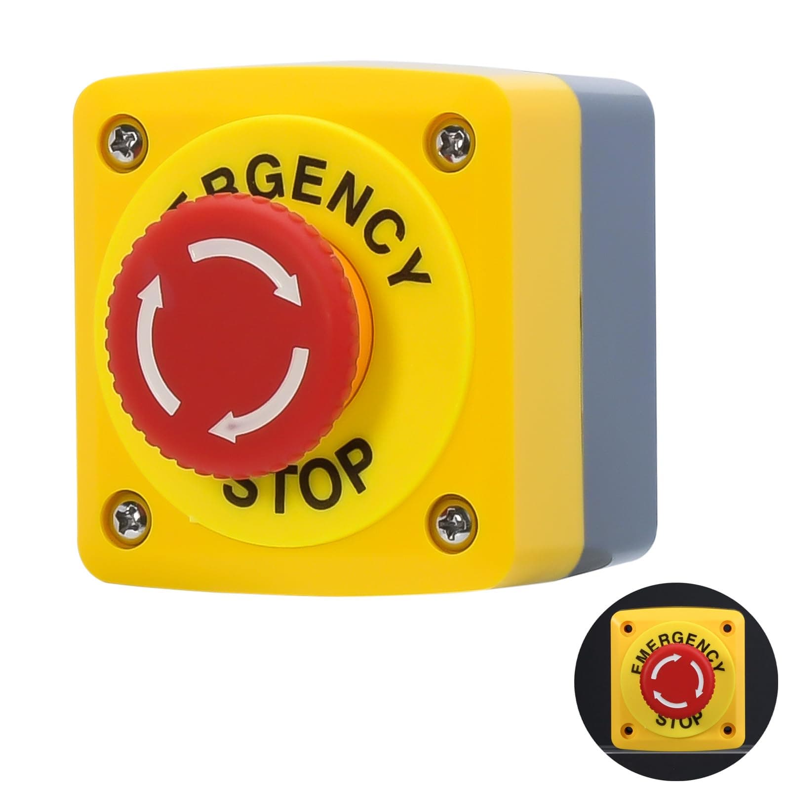

Hi, im new to programming... but for school i have to make a model for our bridge design. i have a question on how to implement an emergancy stop in our code, does anyone have tips on the easiest way of doing this. We tried a power off switch but the teachers told us it is not allowed...It would also be a big help if anyone has tips on showing the stop in a flowchart

Do not put emergency stop in code. Use a complete power OFF switch because that is the safest method.

The need for an emergency stop implies that it could be needed at any time under any circumstances. If that is the case then the only safe way to implement it is a physical switch that cuts power to the whole device.
Any solution involving code reading the state of an input to trigger the emergency stop relies on that code running as expected at all times. You cannot rely on that

And as for the flowchart, since IoT can be triggered at any step (or evens during a multi instruction step), you don’t check for an emergency stop at every step. It’s treated as a global, asynchronous interrupt.
The usual method is to place an external event symbol with a dashed arrow leading to an EMERGENCY STOP terminator, showing it can trigger anytime, outside the normal sequence. The diagram assumes the system or operator will act on it immediately when necessary.

You need to arrange the code so that the emergency stop button is read as often as possible. That means no use of delay() or long for loops or while loops in the code that would cause the emergency stop input from being read

Emergency stops should be immediately effective and not depend on other systems.
If you need to have it in code then it’s just a button you need to deal with. Make sure you write non blocking code and let the loop() run as fast as possible.

How is the bridge opening handled in the code ? Is it done as a number of steps using a for loop, for instance ? If so then that is not a good way to do it. Instead, let the loop() function do what its name suggests and on each iteration of loop(), check whether it is time for the next step.
It sounds like your project would benefit from being written as a state machine. Only execute the code for the current state, ie bridge opening or bridge closing but always execute the code to test the emergency stop input. If an emergency stop input is detected then move to the emergency state, stop moving the bridge and do whatever is appropriate at that point

That’s how professional systems are done ➜ easy = security in that case
Whoever is telling you that does NOT know what they are talking about. I am an industrial electrician and I am telling your instructor he/she is dead wrong and if I discover their identity will be reported.
An EMERGENCY switch is a mechanical disconnect breaking all phases mechanically. It must be red and very visible mounted near the machinery it controls.
It is possible to have an upstream CONTACTOR that is electronically controlled and can be tripped by one of several sensors or other remote switches. One such situation is fire suppression. If a heat/smoke detector is triggered, besides causing the fire retardant to be released it also sends a signal to trip the mains contactor since waiting for a human to trip the emergency off may take to long. I am sure there are other scenarios, but your instructor needs to word the assignment very carefully.

Show this image to your teacher.
"Emergency" is a distracting name because it implies it is for safety, and cutting power is the right answer for a safety issue. If someone dropped a coin into the circuit causing it to misbehave and the bridge was going to crush someone, cutting power is right "Emergency" action. Operators can't depend on the coding to save life & limb.
Maybe think of your software-affecting button as an "abort" or "halt" or "stop" button and do the state-machine stuff per:
