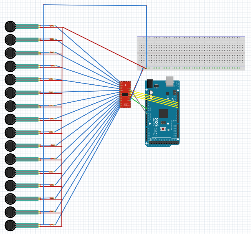

FSR 402 pressure sensor, Mux with Arduino
we want to connect 16 * 1 MUX with Arduino !!
Here is our connection and Arduino IDE code!
We changed channel pin
but in Serial monitor, ONLY channel 0 (S0, S1, S2, S3 = 0000) value is out
Channel wasn't change......
we want to know where is the error...plz help

Where is the 5v connection to the FSRs and Mux ?
In the Arduino IDE, use Ctrl T or CMD T to format your code then copy the complete sketch. Use the < CODE / > icon from the ‘posting menu’ to attach the copied sketch.
What mux are you using ?
it is cd74hc4067❗️

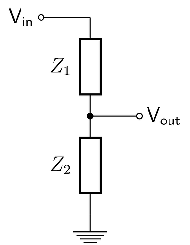

But, the solderless breadboard Red power rail needs a 5v connection.
And
The Arduino GND needs to connect to the Blue power rail.
Do you understand how these basic schematics work ?
