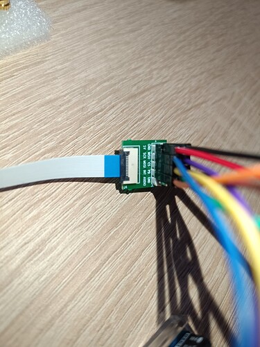

The board you have is an Arduino UNO R4 Minima. Show me with a screen grab that board selected in the Drop Down or the Tools menu.

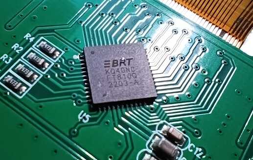

Take a close up photo of the tiny board, both sides and post, also take photos of the front and back of the display board and post. Once we have some basic hardware info we can see if a library exists. I just did a quick Library lookup and got one library. I tried the 'Hello World' sample and other than some insignificant warnings it compiles fine. This is one of many SPI screens so should work but if you are missing the controller card then it is a boat anchor. Until we can see the small card to determine if it is a controller or not my fear is this is a dead duck.

I did the pictures which asked @sonofcy see bellow. Honestly I do not know why i did not see this before but on my screen it is written FT800CB and I was buying FT810 version, but this is other story, anyway the code is not compiling.

I have contacted the supplier of the screen and he confirmed that neverthless the information on the board that it is FT800CB this is FT810CB version.
I have checked the chip on the board and that's true (FT810Q by Bridgeteck).
From your experience and the feedback from the supplier I don't expect it to work. Why not just get something more modern? In any case I can't be of any more help so goodbye.

I have short cables as You can see on the picture:
I did not connect anything to the arduino board beside the screen.

MOSI                  pin 11
MISO                  pin 12
SCK                   pin 13
GND                   GND
VCC                   5.0V
CS                    pin 10
PD                    pin 9
