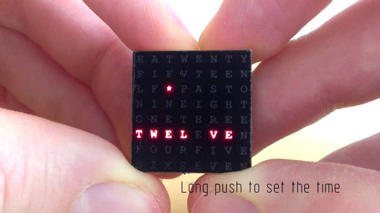

Thought some might be interested in the ASCII display offering show here:
Simple overlay on a 8X8 led matrix.
I find it interesting, small things, small minds, you know.
+1
Pretty neat. What's the 2nd chip?
Looks like a 1307 RTC
Then there is no current limiting to the LEDs shown. I would have expected 8 resistors somewhere, with multiplexing to only have 1 LED at a time on.
You are right (again)!
I assume they used a word find puzzle program to set out the letters/words.
