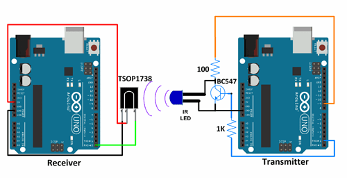

In this tutorial he uses tone() to generate the carrier signal, which is then used in conjunction with a BJT to encode the signal.
I recreated this circuit and I was able to send and receive my signal.
However as far as I can see, this system i harder to scale up, since the LED is powered directly by the Arduino, and if used in conjunction with batteries, it would drain them quickly, since current goes through the BJT when not used in the LED. (Might be wrong about this).
However inspired by this tutorial, I created the following circuit as a way to send my signal;

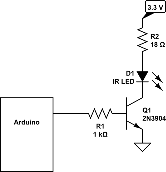

You can use a circuit like this for transmitting. The 18 Ohm resistor is for a 100 mA high power IR LED. Use around 100 Ohms for a standard 20 mA LED.
(IMAGE)
That circuits looks good! If I can get my serial signal and carrier mixed on an eventual output signal from pin3, I think i will use that or something similar. Thank you a lot too!
