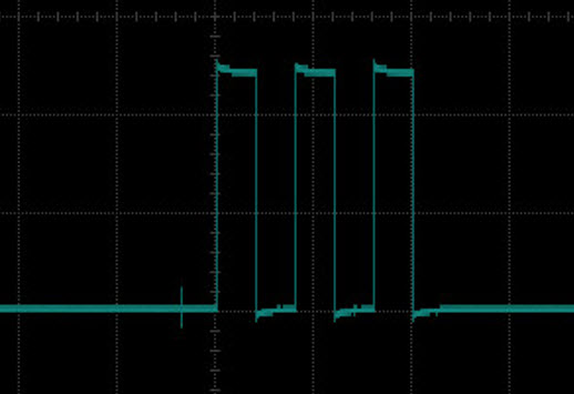

Ahha! I got it.
The pulses are 7.8us wide at the peak, so I set the trigger for pulse, and set the lower and upper time around that. You can sometimes see the edge of a 1ms pulse on the edge of the screen.

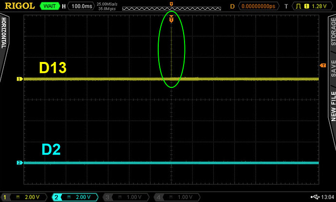

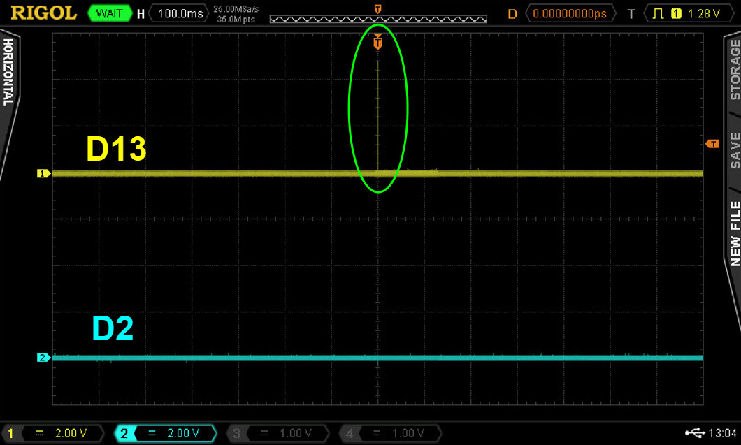

  • You can also add PULSE63_13; to the code and use it to generate a trigger signal.
    if (currenState == LOW)
      PULSE63_13;  //  <———<<<<  add this line
      //create the LED sequence
      for (byte x = 0; x < 6; x++)
        digitalWrite(LED, !digitalRead(LED));
  • In the below sketch line PULSE63_13; was added; place channel 1 on Arduino pin 13, set your trigger for channel 1.
  • Probe 2 goes on LED pin.

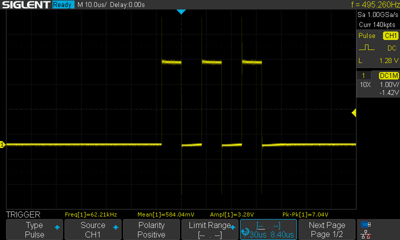

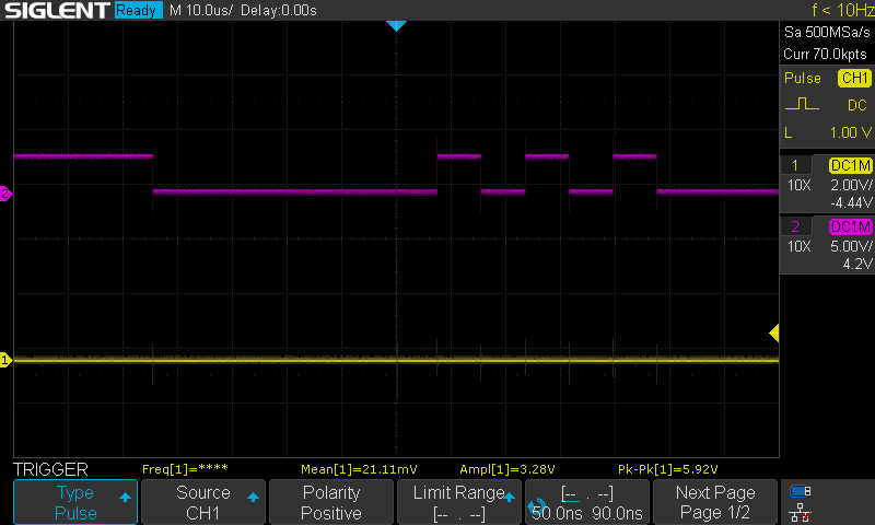

Got you again :wink::
Trigger is set to pulse on channel 1 (pin D13) with a time range of 50ns to 90ns (63ns pulse). It works!

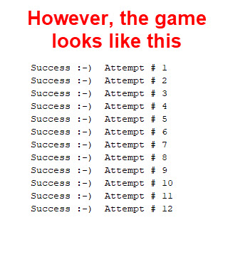

  • Scenario:
A programmer is writing a game.
You need to capture (10 times) a LED's ON state by pushing a switch.
When the LED on D2 lights, the user pushes a switch connected to D8.
If the switch is pressed while the LED is ON, Success is printed on the serial monitor.
If the switch is pressed too soon or too late, the serial monitor prints: LED was not ON :frowning:
After succeeding 10 times, the game restarts and you again have 10 tries.

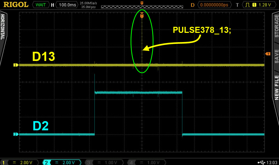

  • Problem:
Catching the LED 10 times does not restart the game :angry: .
The programmer adds PULSE378_13; a scope trigger, to see if the LED is on when the switch is pushed.
Here we see the LED was ON, blue trace, when the switch was pressed, i.e. when the trigger is seen on the scope, Yellow trace.
Here we see the user was too late in pushing the switch:
Here the user pushed the switch when the LED was not ON.
This is what should be printed:

This is what is printed printed:
4

  • Bonus marks.
How long does it take the following function to execute ?
checkSwitches();
Ahha!
The counter variable is a byte, so it never goes negative. Instead of going negative, it goes to 255 and continues to count down from there. if (counter < 0) is waiting for the byte variable to go negative but it doesn't! Instead do if (counter == 0) and add 1 to the counter variable during the definition.
Also, the checkSwitches(); function takes 4.3us to execute once as seen below (without the button being pressed):
Is that correct?
An Expert is Born !
You could make counter an integer:
int counter = startValue;
4.3us :+1:
Awesome!
That was the other option.
