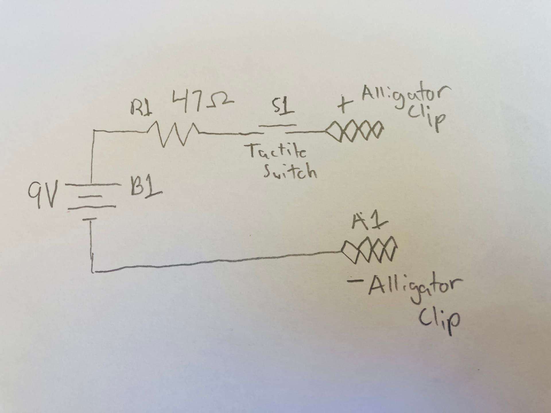

Simple TDR circuit:

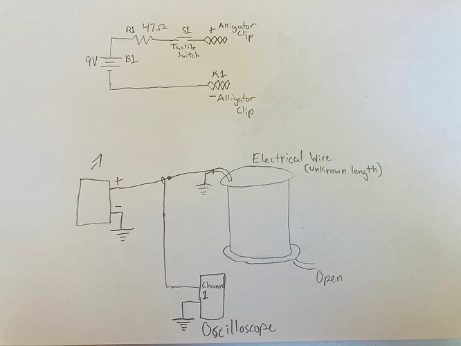

How to wire the setup:

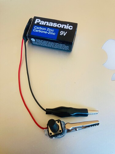

Contraption photo:

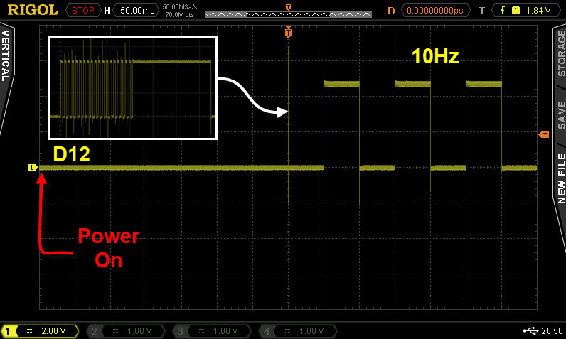

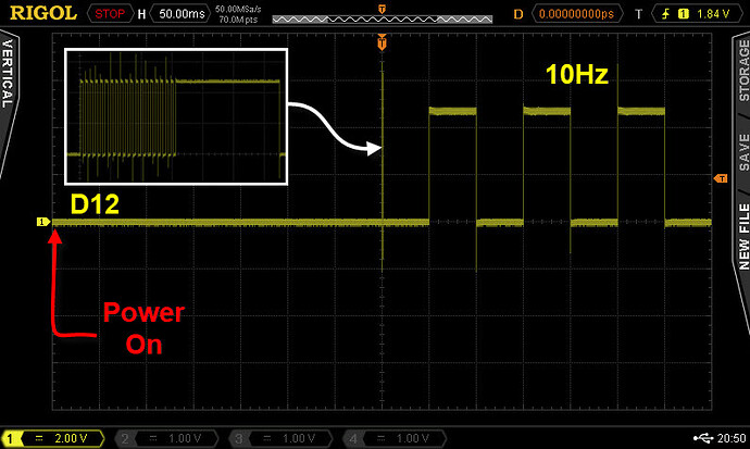

What is the value of clockMillis the first time it is used?
A trick question, eh? It's "uninitialized".
Does that affect the way the sketch runs? :wink:
It can affect it in a bad way. The value โ€˜0โ€™ should be assigned to it during definition. :wink:
When starting a millis( ) based TIMER you must reset it !
One way to Corrected sketch:

Ah, that makes sense.
Do you have any more :wink:?
After breakfast.
:fried_egg:
This is the method I use 99% of the time, see the <--------<<<<< line of code:

  //toggle the clock LED every 50ms
  if (millis() - clockMillis >= interval)
    //if some inaccuracy can be accepted use this      <------<<<<<<
    clockMillis = millis();
    //toggle LED
    digitalWrite(clockLED, !digitalRead(clockLED));
} //END of loop()

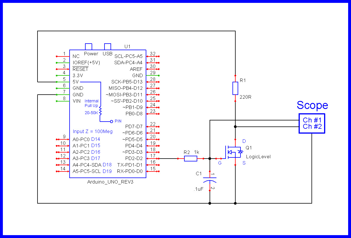

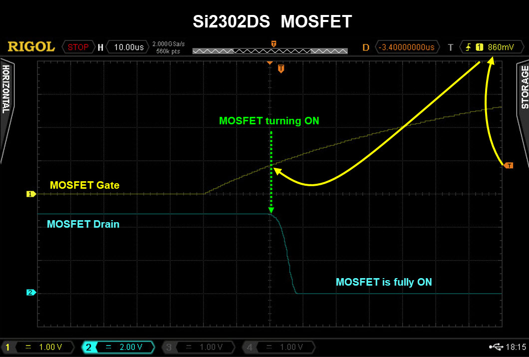

Do you have any logic level MOSFETs ?
Yep! How about the STP90NF03L? I use it for most projects.
Connect your MOSFET as seen in this schematic.
Write a sketch that toggles pin 2 at 10Hz on Arduino D2.

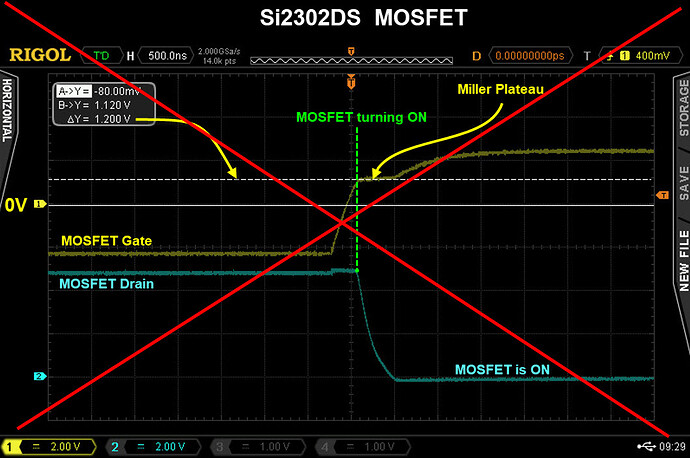

Show us your screen capture of the turn ON chacteistics. (here is mine)
Corrected image:
I think I got it :thinking:.

Here is what the scope shows with the STP90NF03L:
Is that right?
Are you using a 0.1uF capacitor ?
Oh, no. In your schematic, it says to use a 1ยตF capacitor. Is that not right?
It says .1uF
i.e. 100nF
Ah, that explains it. I missed the "." :person_shrugging:.
