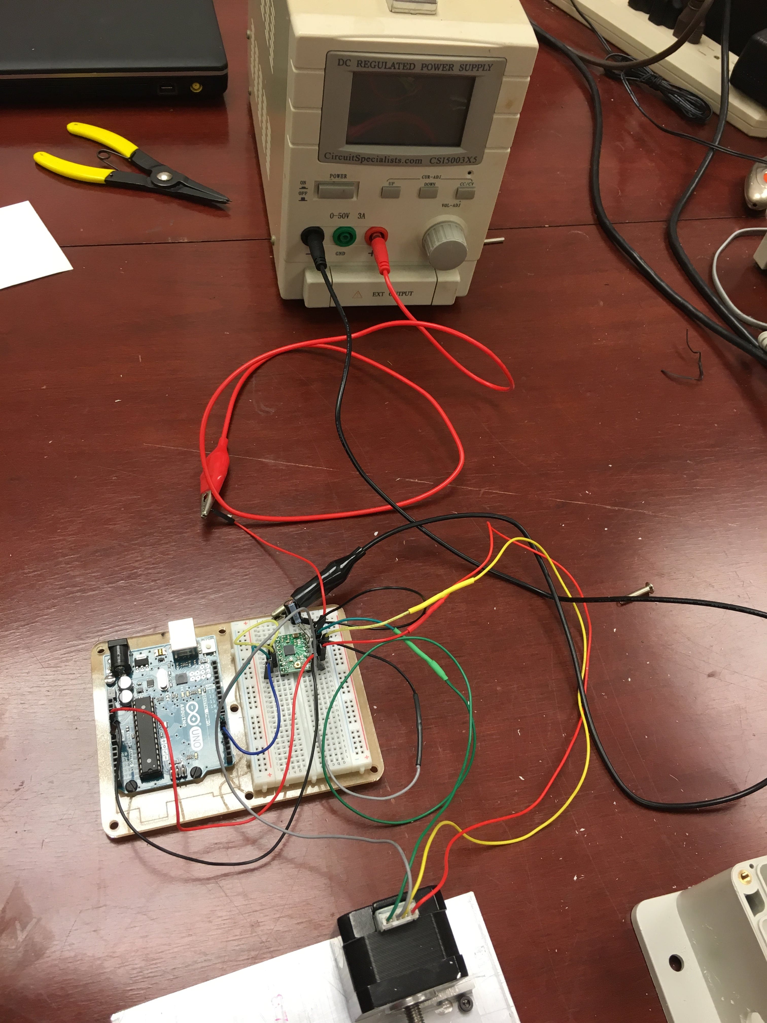

Thank you Robin2, MarkT and TomGeorge for the reply.
Robin2,
I might have some mistake in my wiring . But I have never disconnected my motor from driver while the the driver is powered. However, my motor and driver was really hot. Please refer the wiring diagram and let me know if there is any problem.
TomGeorge,
I have attached the wiring diagram for your reference. Please let me know if you think there is a problem.
MarkT,
Started burning means at the "VMOT" and "GND" location on the right top corner of the driver board I saw smoke coming out and then I saw flame out there.
Thank You,
Devika

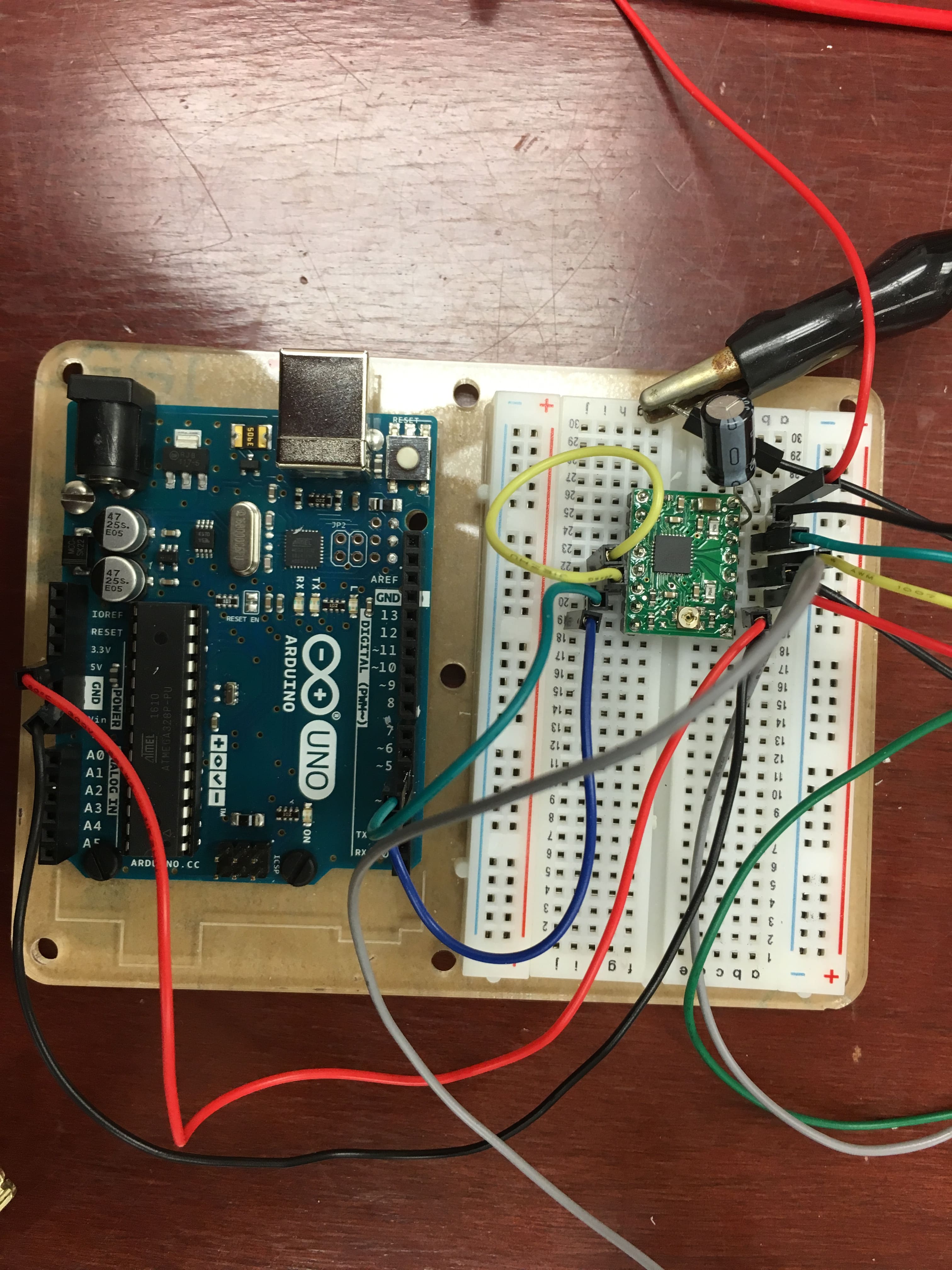

Connections to a motor driver board MUST be made with reasonably heavy, stranded wire, and be soldered.

Breadboards are not intended for high currents (greater than 100 mA or so).
Breadboard connectors may be damaged or destroyed if you try to use them for motors.

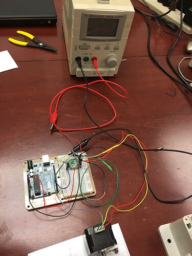

Can you post a picture of your project so we can see your component layout?
Also if possible a picture of your burnt board.
Thanks.. Tom.. :slight_smile:

Hello TomGeorge,
Please find the picture of my connection.
Thank You,
Devika
Hello Tomgeorge,
Please find the picture attached. I have discarded the burnt driver board.
