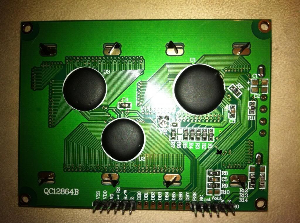

I just got a shipment of the generic "12864 128x64 Graphic Matrix LCD Module ST9720" screens from China.
The PSB pin is hardwired to Vdd, which means that if you attempt to put it into serial mode by taking PSB to ground, you short your powersupply to ground. Gah.

Well, if I ground PSB and I power the screen up from a USB port, the port shuts down from current overload. My fluke DVM says there's 0.2 ohms between Vcc and PSB.
And the screens I got last time work just fine. So it's a defective run... Fortunately I did not fry anything, just a few $ and some hours tracking it down.

0.2ohm would suggest that PSB is indeed shorted to VCC. I would suggest simply finding the trace and cutting it with a xaco knife, be careful not to cut the other traces. But then you will be able to either ground or apply vcc to the pin when needed.
Great minds think alike. Turns out that there was a jumper disguised as a resistor, shorting Vdd to PSB. I removed it and now all the screens work.

I've seen several of these units, all using the same PCB but populated differently. I have one with a tiny SMD contrast pot soldered on the back (the silk screen label is VR1) and positions R6 and R7 are open. Others have fixed resistors, and some have the contrast pin of the chip brought out to the connector.
Looking at the photo, it appears possible that PSB is connected to one side of R9, and R9 may be a 0 ohm resistor (with the other end presumably connected to +5V). Can you check this by visual inspection and with a multimeter? The ST7920 board I have is unfortunately different in that area and so not directly comparable.
You may need to use a multimeter to check whether PSB is connected to R9. My guess is that PSB is connected to both R9 and R10, that the other side of R9 goes to +5V, and the other side of R10 goes to ground. So the display can be fixed in serial or parallel mode depending on which one is fitted, or can be selected via the PSB pin if neither is fitted. So if you want to use it in serial mode, you will have to unsolder R9.
thanks mate...i owe you a big pint I desolderer R9 and it's working now. Thanks again !
