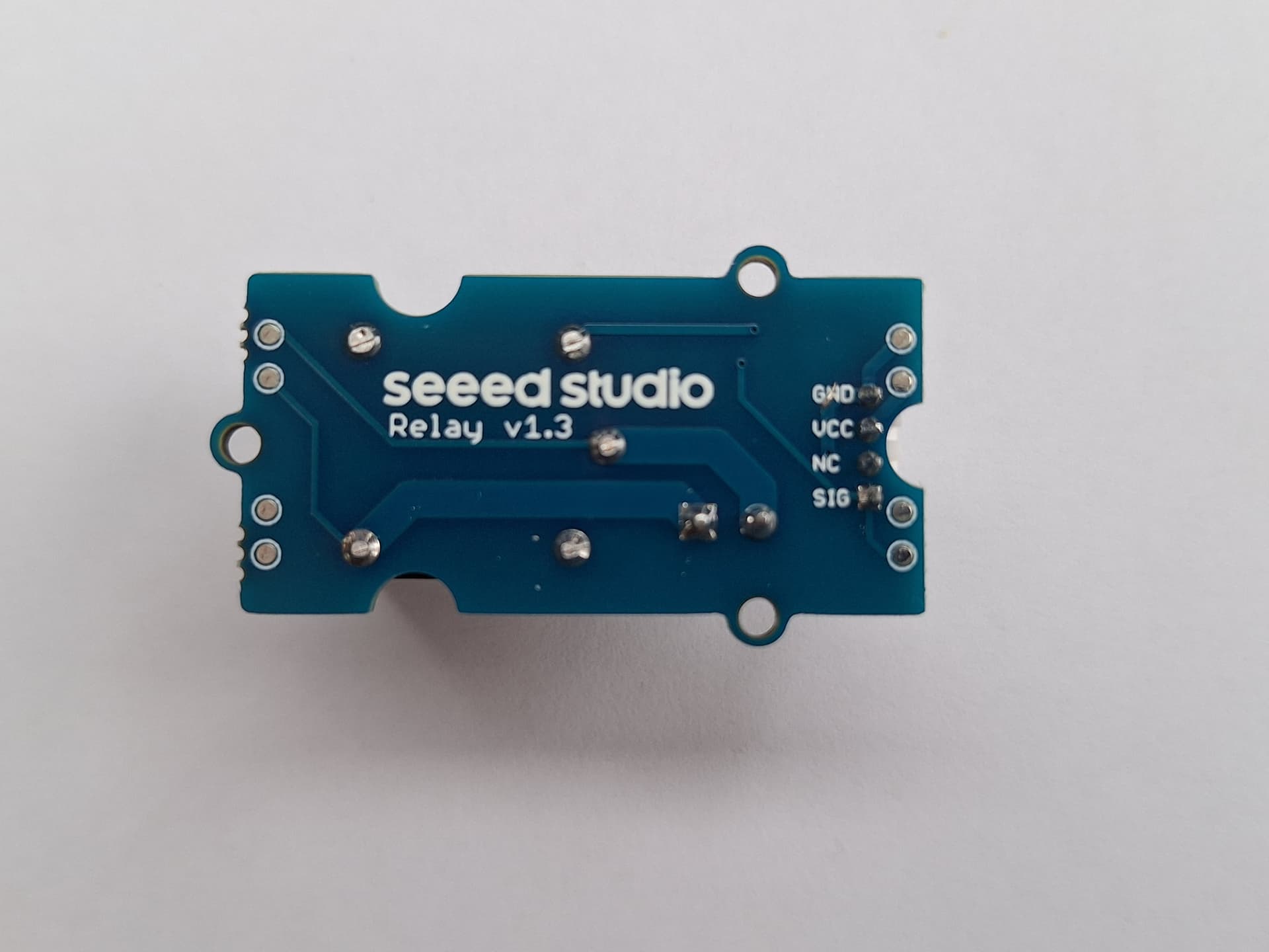

It is version 1.3 <-- that is what is printed on the back.

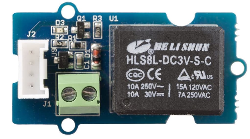

So this module but yours says v1.3 instead of v1.2?
I ask because Seeed don't list a v1.3 on their site. There is a v1.3 of the Grove Arduino Shield, however.
Replacing R1with a lower value or placing a 4k7 resistor in parallel with it might be all it takes to get your module to work. Might be an interesting educational project for the students. On the other hand, since the Grove relay draws >120 mA from the Arduino 5V regulator, you would be better off using the other relay if you need to power anything else from the Arduino.

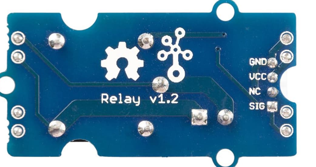

I noticed that indeed both Seeedstudio and the local reseller show v1.2 of the relay, but this is what I got:

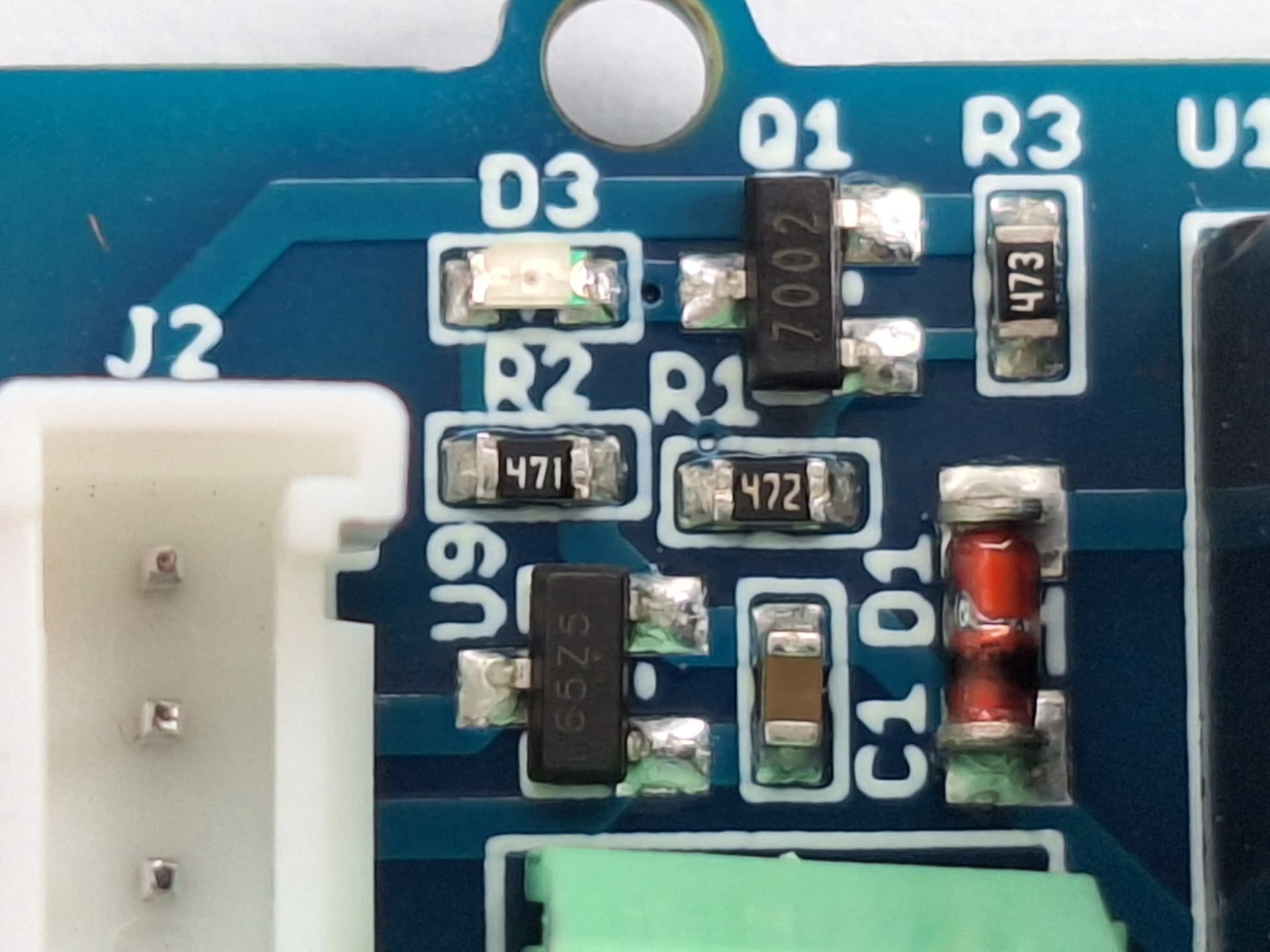

I think the resistors are still the same:

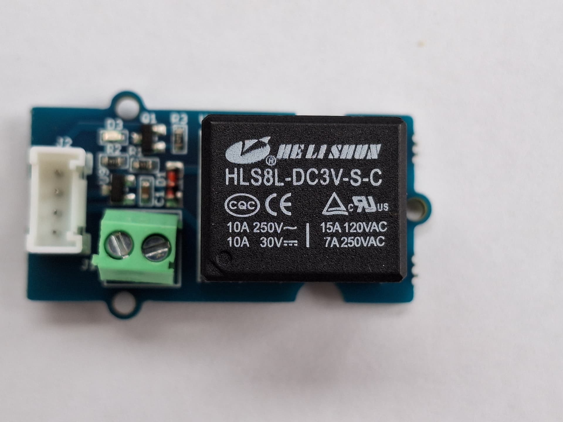

And this is the relay itself:
Yes, 100mA @5v is a lot. I may have to replace them with 'non-grove' relays combined with the converters that @jim-p proposed. I hope the show wants to swith them. I will try to put a 4k7 resistor in parallel anyway before going the route of replacing the relay's. I'll let know of my findings.

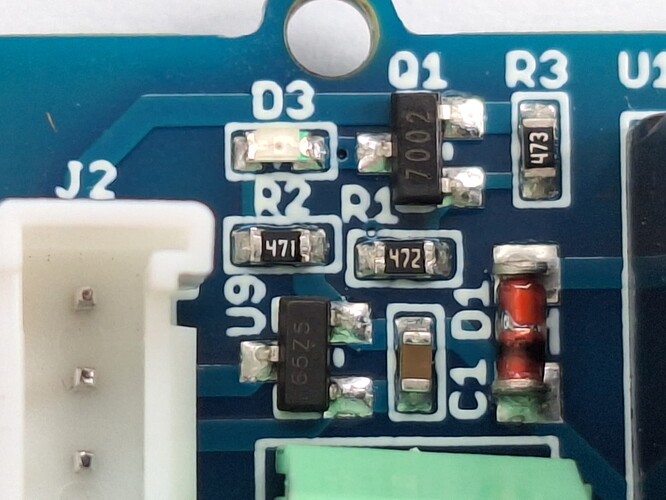

That circuit (post #18) does indeed look badly designed. (1) R3 should go between ground and the label D1 on R1 and not to Q1's base. As it is, only about 90% of the voltage at D1 (the D1 near R1) gets to the base of Q1. That would not be bad for a BJT transistor but, even worse, (2) they appear (picture post #26) to have substituted a mosfet (2n7002) for the original BJT transistor where that voltage drop could be crucial and which anyway is out of spec. You could reduce R1 to say 220 ohms in the hope of improving the behaviour of the relay module.

Use a 1K to 1.5K resistor to make sure the transistor is fully on
If I'm reading the marking correctly, they have changed the BJT to a 2N7002 MOSFET so that would require a different fix. It looks like that possibility is being addressed by @6v6gt in other posts here. It looks like the best solution is not to use the Grove parts at all though.
If the transistor is indeed a 2N7002 as it appears, there is no need to try this fix.
Don't use those modules they will damage your Arduino
I can't believe it. They put a Mosfet in place of the BJT. That would certainly explain why it's stutteing.
