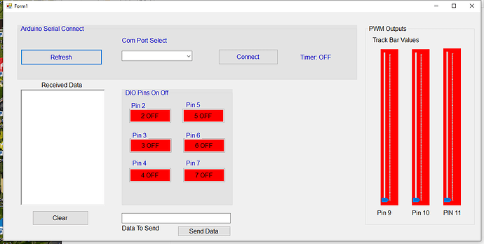

No problem. Here is an example of a basic form I made in VS 2017.
All I am doing is turning On and Off several digital output pins and using some scroll bars to control PWM out of Pins 9, 10 and 11 of either an Arduino Uno R3 or an Arduino Mega. The Arduino really matters not as it could be any other uC depending on the code.
I used VB since I am not a programmer type and If I had to program to eat I would have starved to death years ago.
