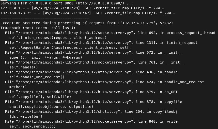

  showBitmapFrom_HTTP_Buffered("192.168.178.31", "/", "remote_file.bmp", 1, 1, 1); // not working,
and
  showBitmapFrom_HTTP("192.168.178.31", "/", "remote_file.bmp", 1, 1, 1); // not working,
Whenever I use a locally hosted server (from python atm) I get a dozen of "Connection reset by peer" errors(3rd line and following). HTTP-Return code is 200.
I can view the image in a browser as expected (1st get request, 2nd line)
The display refreshes and stays white after that.
The SerialMonitor output shows no errors:
grafik
