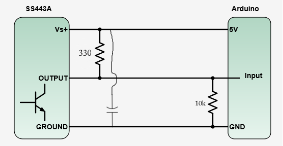

I have 22 arduino's around a model railway running colour light signals. Some actions are triggered by pins being switched by the points (turnouts) and some actions are triggered by trains fitted with magnets passing over Hall effect sensors.
The sensors physically nearest the arduinos are working perfectly, but all those that are located 5+ meters away don't trigger at all, no matter how strong the magnets are or how long or close you place them to the hall sensor. The arduino reads a normally high (pulled up) signal from them and actions are triggered when the hall sensor dips briefly to ground.
I have a 1uf cap across ground and 5v at all the sensors and the cables are twisted pair LAN cable. The sensor pins are pulled to 5v via a 330ohm resistor AND ground via a 10k resistor. Odd arrangement, I know... This is because the proto boards the arduinos are soldered to have been designed to be used with light sensors in a voltage divider arrangement (with a different set of code). I wanted to be able to use the same boards with either light sensors OR hall sensor without physical modification. This way I figured when I add the 330ohm pull-up for the hall sensor, the pull to 5v is much stronger (around 4.8v) and would work in 'reverse'.

The symptoms you describe imply a cable or sensor fault - 330 ohms is a strong pull up and 5m of cable should have negligible resistance and not eough capacitance to matter with 330 pullup. The hall-sensor can handle a 330 pullup (just), so you have about the most robust setup on paper.
Is there a chance of bad interference to the cables causing damage to the sensors? Other than that just retest each part separately, sensor, cable, code... (check the pinout too!)
A digital pin only needs to be pulled up above 0.6xVCC for a "high". That's ~6k66 with a 10k resistor to ground. I would have picked 1k pullup resistors. Low enough for a good "high", and strong enough for 5+meters of ethernet cable. Leo..

Post a diagram showing how you have wired the sensors to the Arduinos. Did you run signal/ground of each sensor on one pair of the ethernet cable. And use 100n ceramic decoupling caps close to each sensor. Is nothing else using that sensor power or ground. Leo..
If you're powering the sensor with 5V and using a 330 ohm pullup, then this is getting too close to the max output rating of 20mA and I wouldn't expect it to switch all the way to GND. If the pullup is at the Arduino, then expect a bit more voltage to be dropped through 2x the cable length.
I would put a weaker pullup (as Wawa suggests) say 1K-4.7K for about 1-5 mA draw when the output is switched on right at the sensor. Test different values for best performance. Then, right at the Arduino, use a 1K series resistor to dampen noise/ringing picked up through the cable. For example:

This is how my sensors are setup (apologies for the modified/bodged diagram!)...
The 10k between sensor pin and ground at the arduino end is for when the board is run with an LDR instead of a hall sensor (creating a voltage divider). I hoped to be able to keep this in place when using the hall sensors instead but that could change if it had too.
The other thing to note is that 5v to the Hall sensors aren't necessarily coming from the same arduino as the signal out/sensor pin. They are coming from an arduino physically adjacent to the sensor to save on extra wiring. All arduinos are being powered via v-in with the same shared power supply.

If you need to keep the 10K, then I suggest this:

So the opto isolator reduces interference from the long cable? Is this essential with the extra 10k to ground in place?
Am I causing issues using 5v from one arduino and connecting signal & ground to another?

There are other bits of circuit using the arduino 5v rails for example to run variable resistor pots to input values to analog arduino pins and another hall sensor (up to 3 hall sensors per arduino). The ground is common to all the arduinos.
The opto-isolator would eliminate interference and also provide full voltage swing on its output.
The circuit in reply #9 doesn't need the 10K (it would make the circuit fail as the signal wouldn't rise high enough with the internal pullup).
The 10K is required for the latest circuits (so you could leave it in place. I recommend inverted signal diagram for ease of swapping out the sensor for the LDR (the 4N35 could stay in place).

I was asking if the problem sensors are star-connected to one Arduino. And the power/ground does NOT go further to other devices. Because that could cause problems. Don't understand why you use 22 Arduinos for a train setup. I also don't understand why an opto setup is needed for small (almost) DC signals. Leo..

I don't know. Did not see a diagram with parts values, or code, or hall/magnet timings. A train over a hall sensor is, for the Arduino a very low frequency. Cutoff frequency (RC filter) can be low. What is the value of the cap from Arduino digital pin to ground. Leo..
Good point. I didn't include code as I had come to the conclusion it's likely to be a general electronics issue as it works over short distance. Or more accurately an issue with my knowledge on electronics in general :confused:
The cap is 0.1uF ceramic across ground and 5v right at the hall sensor. I wonder if this should actually be at the arduino end instead ? I'm sure I read somewhere that it should be close to the sensor.
The code uses pin change interrupts with the 'enableInterrupt' library. When the sensor pin senses a ground pulse, a function is executed. On the sensors nearest the arduino that are working, even the fastest train triggers the sensor without issue.
