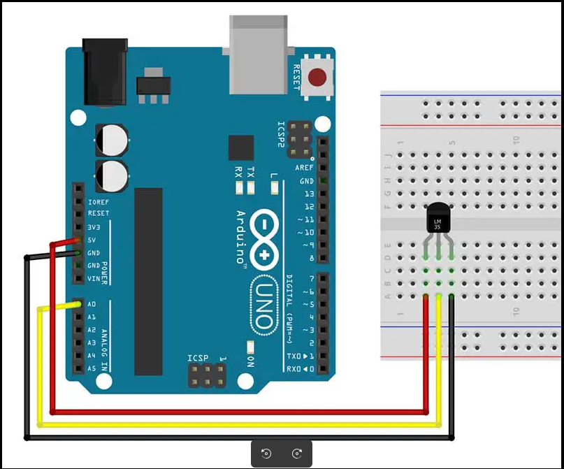

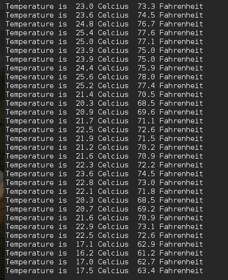

Hello, I just started a project with LM35 (temperature sensors) with Arduino, after mounting it on my breadboard I noticed that the values ​​in the serial monitor are inconsistent and vary in a strange way, for example I get 21°, 20°, 22° 24° successively which is impossible I get the bad results with 5 different sensors, even whern i use a heat source the temperature the values vary also in a strange way and I don't know where the problem is can someone help me please and also when approching a heat source the temperature decreases instead of increasing !

Also look at the raw numbers. If the readings are going in the right direction (up when the temperature increases).
If only the calculated temperature goes in the wrong direction you've got a software problem. The raw counts will have more variation because they have higher precision.

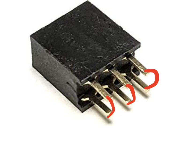

Given that you are using a breadboard that is, in all likelihood, of poor manufacture, those results are to be expected. Use a double female HDR and plug the sensor on one side and the Dupont wires to the board on the other. This is the next best solution to soldering and is probably 99% as good.
What has that to do with the issue?
The OS will not affect the readings.
i have already tried wiring LM35 directly to arduino but i'm having same result
I was thinking you can get female hdrs that are double and joined but maybe not, so get a double row female and solder a jumper across each of the pins like shown but at the top so it can still sit in a breadboard for convenience.
How, soldered?

i tried your code i approched a heat source and the temperature start decreasing !!
A0, I caught it 3ms after hitting reply, TNX.
My code did not produce that.
do you have any idea where the problem is ?
Bad connection somewhere, defective sensor, connected wrong are the only possibilities I can think of.
If reading is backwards as you say when approaching heat source then the sensor is wired wrong.
Just for giggles, experiment with the sensor connections.
You might also have a noisy power supply. But that shouldn't cause BIG problems... As long as the Arduino and LM35 share the same power supply, most of the noise & variations should cancel-out.
If you have a multimeter, measure the LM35 voltage output. If it's jumping around too much that may be clue (there is always SOME noise). Check the 5V too. Of course the meter has its own reference so any nose/variation won't get canceled-out But meters also have some filtering/smoothing so the voltage may look more stable than it is.
